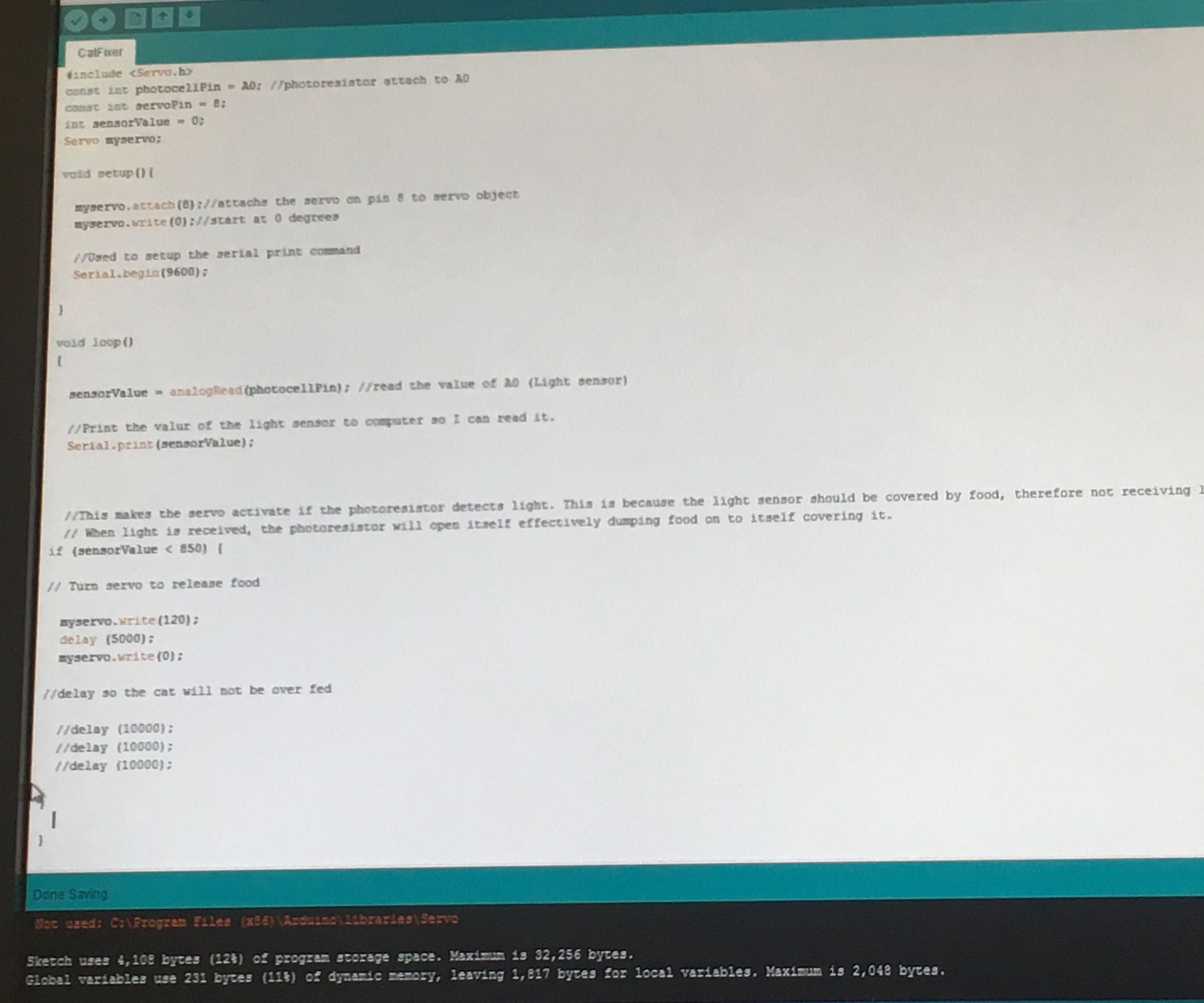

Step 4: Step 4: the Code
Next go into the program file and insert the following code shown on the picture above.
Replace "/media/" with the directory to the USB in where your photos are located. If you are not using a USB you can use a directory on your Pi that contains photos you would like to display. feh -Y -x -q -D 5 -B black -F -Z -z -r /media/ feh at the beginning of the line calls the command to run the slideshow The letters with a "-" in front are settings for the slide show. The list of these commands are displayed below: Z Auto Zoom-x Borderless-F Fullscreen-Y hide pointer-B image background-q quiet no error reporting-z Randomise-r Recursive search all folders in folders-D Slide delay in seconds
