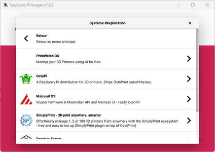

Next, you'll need to install Mainsail OS onto the Raspberry Pi. To do this, follow these steps:
  1. Download and install the "Raspberry Pi Imager" software.
  2. Use the Raspberry Pi Imager to flash the appropriate OS to your micro SD card.
  3. Select Mainsail OS from the menu: Other specific-purpose OS -> 3D printing -> Mainsail OS.
Insert the flashed micro SD card into your Raspberry Pi and power it up. This process may take some time.

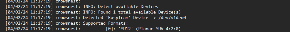

First, you'll need to dump the Crownest log to identify the name of your camera device. Once you've determined the camera name, you'll need to define it in the crownest.conf file with the following settings:

Replace /dev/videoX with the correct device name you identified from the Crownest log.

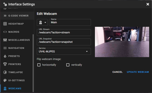

After updating the crownest.conf file, you can define your first webcam settings in the Mainsail OS settings menu (accessible via the gear symbol in the top right corner).
You should now be able to see your camera feed at this stage of the setup.

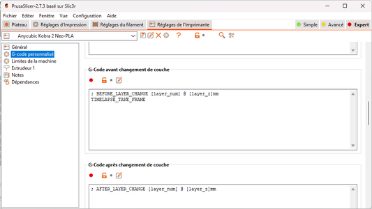

Additionally, in your slicer settings (e.g., PrusaSlicer), make sure to add timelapse instructions at each layer change to capture the printing process effectively. You can usually find this option in the slicer's configuration page.
