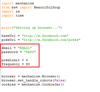

Boot up the Pi and make sure it has an internet connection, then copy the file to the Pi (via USB or from Git). To set up the file (see picture), open it in a text editor and change the login info to match your own. You can also change the frequency at which it checks for new pokes, and the maximum amount of new pokes to accept before giving an error (for not poking everyone under "Recommended Pokes" if Facebook updates).

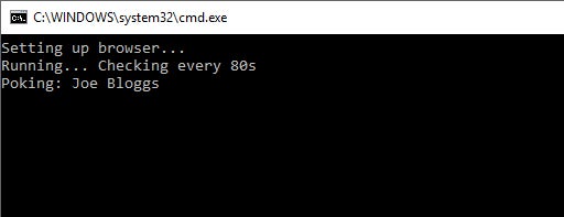

That's it, the program should print the names of the users it pokes to the terminal.
