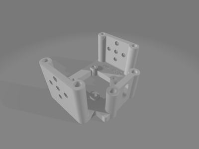

Step 6: Build the Foundation
Now we get to the 3D Printing part of the telescope. The telescope consists of 5 major assemblies. The Foundation, the Platform, the Tower, the Gearboxes and the Dome. Take your time with printing the components, I estimate you need about 4 spools of filament (1.75mm filament, 1kg per spool). 2 spools of Black and 2 spools of White are ideal, but why not get creative?
3D Printer settings
  • The telescope prints nicely with PLA material.
  • I recommend around 0.12mm layers for a few small fine-detailed components.
  • I recommend around 0.2mm layers for the majority of components.
  • Components are generally stronger if you have 3-4 layers for wall, floor and ceiling thicknesses and 20-40% infill.
  • If your prints are reasonable quality, no further strengthening is needed. However if you have issues with layer separation, some of the more critical parts have holes in them which you can use to add supporting bolts or just fill with adhesive to strengthen them.
The foundation is the static base that the telescope sits on. It consists of a three footed base which supports a Lazy Susan bearing, this bearing takes the weight of the upper telescope body and allows it to move left-right (azimuth).
The .STL files for the foundation components are available here.

Step 8: Build the Camera Tower
The camera tower sits on the platform, it holds the electronics, altitude motor, gears and camera. I printed this in BLACK PLA.
The camera tower consists of two inner walls which are joined by a camera cradle. The camera cradle is mounted on bearings so that it can rotate freely up and down. The camera cradle is moved by a stepper motor and gearbox.
Each inner wall is made of two wall pieces which are bolted together to hold the RC bearings which support the camera cradle. See the video for more information.
There are two versions of the inner wall available. P.14.0 is a lower profile which gives a little more space under the dome, P.13.6 has more bolt holes available to help mounting electronics to the tower. The video uses P.13.6.
The .STL files for the camera tower are available here.
There is a brief video to take you through the assembly.
