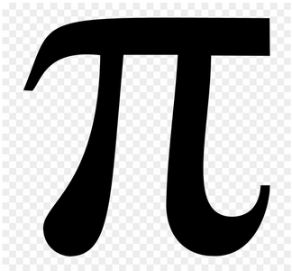

Step 1: Transforming Pi Into a 3D Object
Choose a shape for your calculator clock. It should be able to stand on its own when 3D-printed. Find a picture of it on the internet. I chose Pi as my shape (see Step 13 for more information on Pi) and I used this picture: https://www.clipartmax.com/middle/m2i8A0m2K9i8K9K9_pi-symbol/ (Accessed on 2022/10/14)
In the next steps I am going to show you what to do for Pi. If you chose a different shape you might need to adjust the instructions a bit.
Then open the image in your conversion software (I used Microsoft 3D-Builder) and change the size to what you need, the measurements of my Pi are 125*121*64.5mm. The depth should be a little more than the width of your LCD. Then convert it to a .stl or .obj.
