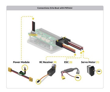

Step 2: Assembly
PXFmini Configuration
The PXFmini should be configured. Request the latest image for your PXFmini or acquire a flashed one with your order to Erle-Robotics.
Having the PXFmini you need to:
- Set as a Erle-Rover
The easy method is via HDMI with the Erle-Robotics User Interface
- Connect via network to APM
Connect via network to APM and Load Parameters for Erle-Boat
Step 3: PWM Inputs
The ESC should be connect to the motor and to the PXFmini's PWM #3. The Servo, need to be connected to the PWM #1
Everything in place
Ensure everything is in place. Check that the motor and servo can move free.
