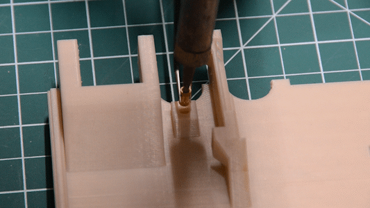

Threaded Inserts
- Diskette Bay Mount, 2× M2×6mm Inserts connected with M2×6mm Bolts
- Audio Board Mount, 2× M2×4mm Inserts connected with M2×6mm Bolts
- Extra Knob Mount, 1× M2×6mm Inserts connected with M2×6mm Bolt
- Power Switch Holder, 2× M2×4mm Inserts connected with M2×6mm Bolts
- The switch was securely fastened by the tight fit and springy plastic parts on the casing, so I didn't end up using these
- Electronics Panel Mount 1× M3×6mm Inserts connected with M3×6mm Bolts

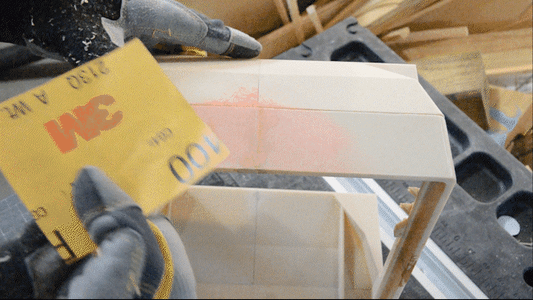

Finishing Notes
- Glue and clamp pieces together
- The diskette bay overhand will need to be sanded well to remove some of the support lines.

Finishing Notes
- Clean up any support, brim, or stringy material from the vents.
- Glue and clamp pieces together, one by one
- A good strategy for joining pieces gradually evolved while doing this project: try to minimize degrees of freedom for the glue/clamping. This isn't how it appears in the first photos here, but I'd recommend first glue/clamp together two of the four Display Front pieces, and then the other two separately, and then join those two sets together using single direction of clamping. Likewise, then join the Display Rear pieces in a similar manner. Once the Front and Rear assemblies are complete, finish the Display by joining these with a final axis of gluing/clamping.
- Add spot putty on joints
- Sand well with 400grit until smooth

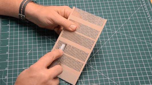

Step 3: Case
Pieces: Case Top Left, Case Top Right, Case Tippy Top, Case Rear Panel, Case Rear Panel Handle, 60mm Fan Cover
Printing Notes
- There are several version of the Case Top Left and Top Right pieces which have different mounting sizes for different speakers. Select which one fits - if there is a popular speaker size that isn't listed, I can help make another version with the provided dimensions.
- The venting printed on the bed of the Case was troublesome to print on my PEI. After increasing bed temperature, leveling with OctoPrint Bed Visualizer and BL Touch a number of times, and adding some brim support in Cura, it finally started to stick well.
- The Case Rear Panel was similarly tricky, it is nearly as big as the entire Ender 3 bed surface - any discrepancy in leveling resulted in peeling. I ended up printing with Brim Only on Outside unchecked, which caused brim material inside the groove. This helped it to stick, but it was terrible to remove all that material.
- Note: the design on the original PS/2 has an inlay on the exterior surface of the vent. To faithfully recreate this without massive amount of jagged support material, it is necessary to print this portion bottom up. Unfortunately, the sides of the case, which are attached here need to be printed in the opposite direction. So these pieces were split to keep the original effect intact, while still being print-able.
- If you don't already, you'll have a well calibrated printer once you're finished printing all these pieces.

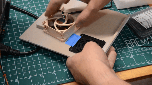

- Fan, 4× M3 washers & nuts connected with M3×12mm Bolts
Finishing Notes
- I combined the Case Top Left and Right together first, and then aligned the Tippy Top to complete.
- Gluing the Tippy Top and the Case Top pieces together a bit awkward with all the venting, especially on the sides. I came back and did a second pass on some side vent pieces that didn't glue well the first time.
- The Case Rear Panel Handle gets glued to the Rear Panel, this removes the need to add support material
- Add spot putty on joints - this is mostly just at the rear section where Top and Tippy Top pieces meet.
- Sand well with 400 grit until smooth

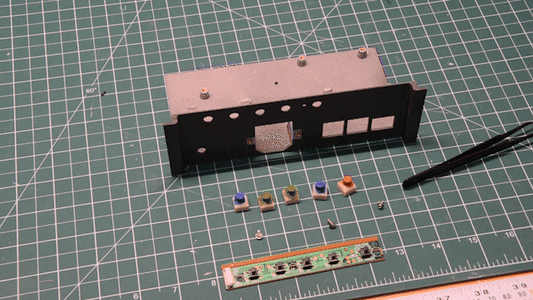

Step 6: Electronics Board
Pieces: Electronics Panel, 6mm button Cover ×6
Printing Notes
- Supported needed for the Electronics Panel for the power socket and raspberry pi socket openings (unless your printer is up to epic bridging!)
- I did this by adding support everywhere, and then using Support Blocking for the circular openings and the display controller icons.
Threaded Inserts
- Rasp Pi Mount, 4× M2×6mm Inserts connected with M2×6mm Bolts
- LCD Control Keyboard mount, 3× M2*6mm Inserts connected with M2×6mm Bolts
- Buck Converter Mount, 2× M2×6mm Inserts connected with M2×6mm Bolts
- Power Socket Mount, 2× M2×6mm Inserts connected with M2×8mm Bolts
Finishing Notes
- Cover threaded inserts with tiny squares of painter's tape.
- Prime and Paint "Onion Grey", 2 coats

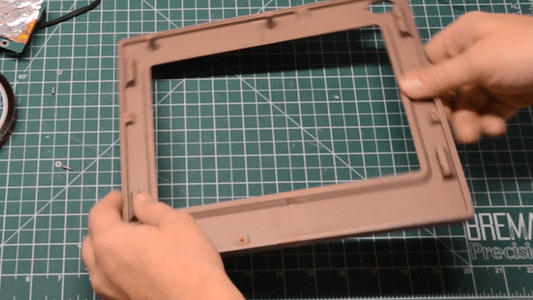

Step 7: Bezel
Pieces: Bezel Lower Left, Bezel Lower Right, Bezel Upper Left, Bezel Upper Right, Bezel Front Icons, Bezel LED Mount, Bezel PiBM Logo
Printing Notes
- Supported needed for the Bezel Lower Right for the LED mount and Icons
- The PiBM Logo is legible with this printing set up, but switching to a smaller nozzle size for both that and the Front Icons might lead to a cleaner result.
- Print the LED Mount in black.
Threaded Inserts
- LCD Control Board mount, 3× M2×6mm Inserts connected with M2×6mm Bolts
Finishing Notes
- Glue Front Icons onto the Lower Right piece
- Glue together bezel pieces. The photo has an attempt to glue all four corners together at once - this worked, but next time I will do two at a time.
- Add spot putty on joints, sand until smooth
- Prime and Paint "London Grey", 2 coats

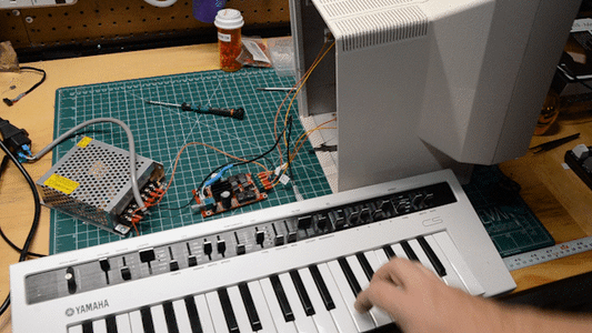

When mounting, first place the SD card reader into place (if it works!), then place the spring in the Eject Button slot and then cover with the Eject Button. Have the Front Panel facing downward. Get both bolts and washers into place, and carefully slide into position. I highly recommend using a longer hex screwdriver for this step, the space is a little tight.
This completes all printable components - now it's time to wire it up.

The audio amp will allow you to hear your PiBM in magnificent stereo. It is mounted on the back of the Front Panel so that one of the forward facing knobs controls the volume. But before that, the first step is to wire up the speakers and give them a test.
Depending on which speakers you have, it most straightforward to solder your wires directly to the speaker connections. Label those wires for Left/Right & Positive/Negative. To plug the opposite ends of the wire into the amp, I used the same idea of a spade terminal connector, trimmed slightly. Mount the speakers in the top of the case using M3 bolts.
I used an audio device plugged into the amp with the 3.5mm jack. You can test using your Raspberry Pi - just make sure it is set to output via analog. Secure all the speaker wiring in place, then plug in the power connections and turn it on and turn it up.
If this is all working, carefully turn off the power and disconnect the wiring. Next it is time to connect the switching audio jack - this is where it gets a bit more complicated. This device has five pins to route the audio. The first three are Sleeve, Tip, and Ring, which are the standard pins to connect stereo audio. These will be routed to the audio out jack on the Raspberry Pi. The fourth and fifth pins on the switching audio jack are used to route the audio signal to another device if nothing is plugged in. These will be routed to the amplifier. See the schematic.
First solder hookup wires to the audio jack. Also get a 3.5mm audio plug ready - I reused one from an old pair of malfunctioning headphones, finding the Tip Ring Sleeve (TRS) using continuity mode on the multimeter. Use a circuit breadboard and wire up the schematic, testing the audio in the same manner as before. This time, make sure audio is being delivered to both speakers, and when a headphone plug is inserted into the switching jack, the audio is routed though the headphones and not to the speakers.
Finally, use a small prototyping board and three JST XH housings/plugs, one 5 pin and two 3 pin, and connect the pins with soldered wiring as they had been on the breadboard and schematic. I used a M2 riser (and some M2 washers) to mount this board above one of the corners of the Raspberry Pi.
The headphone jack is designed to snap into place on the board, with the pins facing towards the Raspberry Pi. The Audio Amp gets mounted on the Front Panel, make sure to install this before the Diskette Mount, as it will block access to the lower mounting bolt.

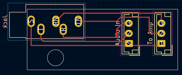

Update 1/19/2023
- I've added a PCB gerber file for an audio jack connection board - this simplifies all the wiring. It requires the 3.5mm jack and two JST XH 3 pin housings. I ordered from PCBWay and it was a 20 min job to solder and replace the existing connections. Get the source in the "Other files" section here.

- Mount LCD Panel into the bezel using M2 bolts and washers
- Mount Video Control board over the panel, I had cut a piece from an anti-static electronics bag and attached it with polyimide tape to the back of the board to guard against any shorts
- Print and insert 6mm keys into the back of the Electronics Panel, attach the LCD Control Keyboard using M2 screws.
- Connect Video Control board to Raspberry Pi using Micro HDMI to HDMI cable.

- Finalize all mounting. In the end, I'd recommend going in this order, but your mileage may vary
- LCD Panel, LCD Control Panel, Video Control Keyboard, Speakers, Power Switch, Audio Amp, Extra Knob, Diskette Mount, Power Supply, Power Socket, Buck Converter, Raspberry Pi, Audio Connector board, Headphone Jack, Fan.
