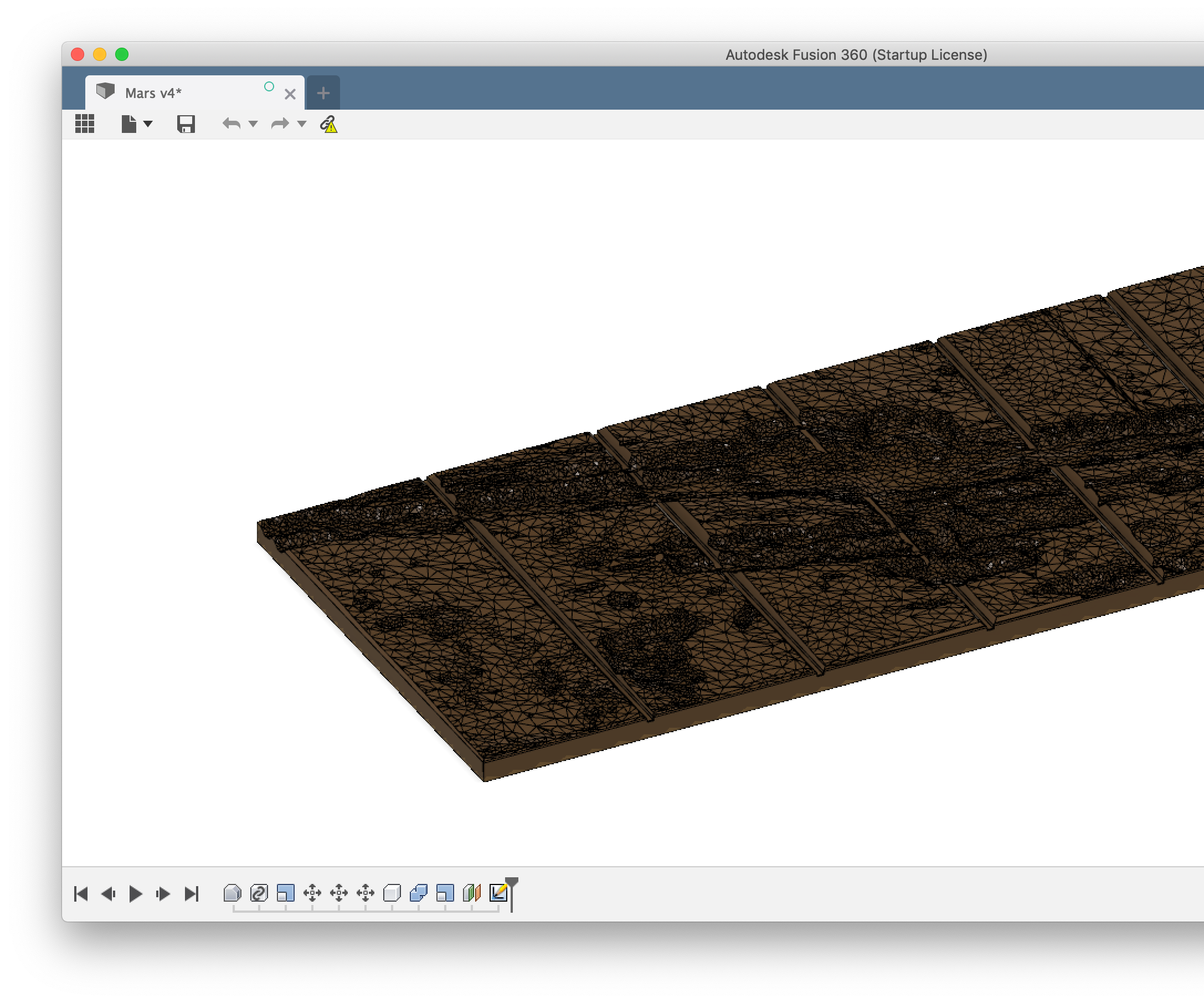

I start all my project in Fusion 360 so lets start there. I teach a class at the Milwaukee Makerspace and made this one of my classes. Link to the video below for instructions on designing your box.
Designing your box link
