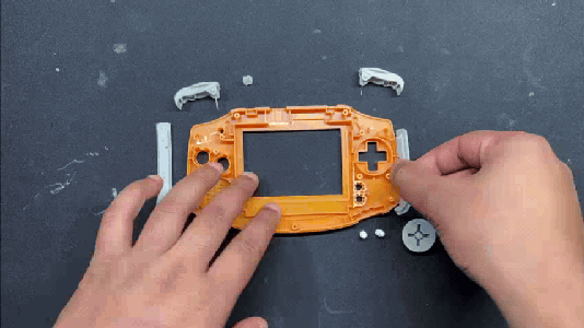

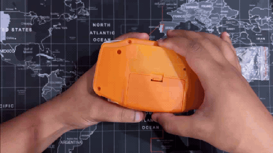

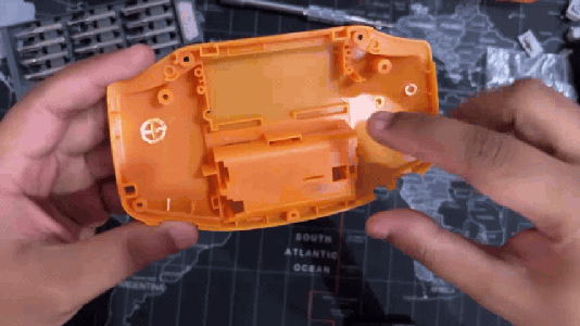

Step 2: Game Boy Advance Shell
One of the most important parts of this project is the Original Nintendo Game Boy Advance replacement body kit, which I purchased from a retro game vendor that sells vintage consoles like the PS1, PS2, XBOX, and others at a local electronics market.
I saw this orange Game Boy advance shell while the seller was selling replacement body kits for handheld devices, and it made me think, "Why not build the entire Game Boy from scratch?" Since the body is brand new, all I had to do was develop the circuitry, which should be really, really simple.
The D-pad, A, B, and trigger buttons are all included in this shell, along with the front and rear enclosures and a few more pieces on the left and right sides of the device.
It even features a Game Boy Advance logo and a front PC Cover, this PC cover part has an adhesive tape stick on the back, which allows us to take off the protective covering and attach it to the front body.

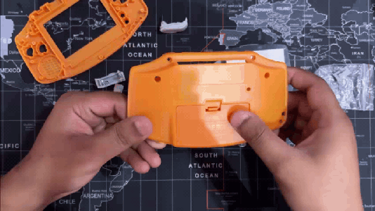

Step 3: Shell Body Edit

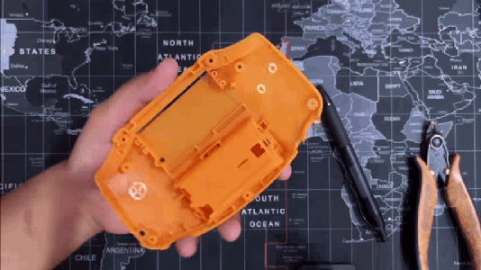

We can construct our PiBoy in this shell, but there is a minor glitch: the Game Boy Advance's PCB size. The existing PCB of the Game Boy is smaller than our PICO and other components. To create room for the new circuit, the Game Boy's battery compartment, which is located on the back end and a few pillars must be trimmed out.
- Using nipper pliers, we began the shell body edit process by removing the screw bosses on the left and right sides of the rear end.
- The AA cell holder is then fully removed; however, we must be careful not to remove the lock mechanism, which is necessary for attaching the cell cover.
- We were able to add our own circuit inside the shell by making these two adjustments, and this step ensured that there would be no space issues.

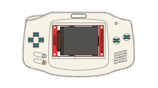

Step 5: DESIGN
Now for the toughest part of the build—designing a custom PCB to fit the shell.
Making a PCB is pretty straightforward when you control the enclosure’s shape and dimensions. If you're designing the body from scratch, you can model everything to fit perfectly. But when you're working with a random shell, especially one without any reference files, it's a whole different story.
In my case, I picked up the shell from a local electronics market. It wasn’t an official Nintendo part, just a low-cost aftermarket version that felt a bit flimsy.
I paid around ₹800 (roughly $9.50), so I wasn’t expecting perfection, but that also meant no STEP file, no clean measurements, and a lot of guesswork.
Fitting a custom circuit into that kind of housing took serious trial and error.
The modeling process kicked off with a bit of luck and a lot of manual work.
I started by searching for a 3D model of the Nintendo Game Boy Advance and surprisingly, I found one that included all the key structural details: screw bosses, ribs, lips, grids, and more. It looked promising at first, but there was a catch. While the model had accurate hole placements and component outlines, the alignment was off. If I had followed it as-is, the PCB wouldn’t have matched the shell properly.
So I took the long route: manually measuring every screw boss, grid, and rib inside the shell, then correcting their positions in the 3D model. Once the geometry was dialed in, I designed a custom PCB around those mounting points. This board included push switches, the ILI9225 display, and the MAX audio module.
To validate the fit, we 3D printed the PCB and test-mounted all the components. After a few tweaks and iterations, we finally had a board that fit the shell perfectly custom-shaped and tailored specifically for this Game Boy Advance body.

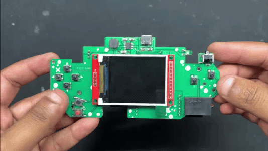

Step 6: PCB Design
The PCB for PiBoy Advance is split into two major sections: the Pico Setup and the Peripheral Connections. At the heart of it all is the Raspberry Pi Pico, which interfaces with the ILI9225 display, the MAX98357 audio module, and a set of push buttons for user input.
We’ve made full use of the RP2040’s GPIOs to handle all button inputs:
- GPIO2 - Button Up
- GPIO3 - Button Down
- GPIO4 - Button Left
- GPIO5 - Button Right
- GPIO6 - Button A
- GPIO7 - Button B
- GPIO8 - Select
- GPIO9 - Start
The SD card slot of ILI9225 is wired for SPI communication with PICO through following GPIOs:
- GPIO12 - MISO
- GPIO13 - CS
- GPIO14 - SCK
- GPIO15 - MOSI
- GND - Pico GND
- VCC - Pico VBUS
The Display is powered via the Pico’s 3.3V and controlled through the following GPIOs:
- VCC - 3.3V
- GPIO22 - LCD LED
- GPIO21 - RESET
- GPIO20 - RS
- GPIO19 - SDI
- GPIO18 - CLK
- GPIO17 - LCD CS
The audio module is powered by VBUS and connected as follows:
- VCC - Pico VBUS
- GND - Pico GND
- GPIO28 - LRC
- GPIO27 - BCLK
- GPIO26 - DIN
The second major section of the PCB design focuses on power management—an essential part of any handheld device.
For the PiBoy Advance, we chose a single-cell LiPo battery as the power source, charged via a USB Type-C port. To handle power regulation, we integrated the IP5306, a compact power management IC capable of delivering a stable 5V at up to 2A from a 3.7V Li-ion or LiPo cell.
The IP5306’s output is routed directly to the VBUS pin of the Raspberry Pi Pico, which in turn powers the display, the Pico itself, and all other components on the board. It’s a clean, centralized setup that keeps the system efficient and compact.
This IC also includes smart features like low-cut and high-cut protection and a battery fuel indicator LED. During charging, the LED blinks slowly and becomes solid once the battery is fully charged. When the battery is low, it blinks rapidly every two seconds—making it easy to monitor power status without extra circuitry.

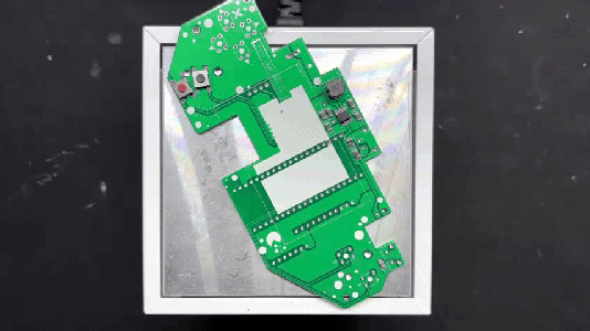

Once the schematic was finalized, we moved on to the PCB layout. The board outline shape was based on the shell dimensions, and component placement was guided by the 3D model.
The top side of the PCB houses all SMD components, including the display and push buttons, while the bottom side holds the Raspberry Pi Pico, battery terminals, and the MAX98357 audio module.

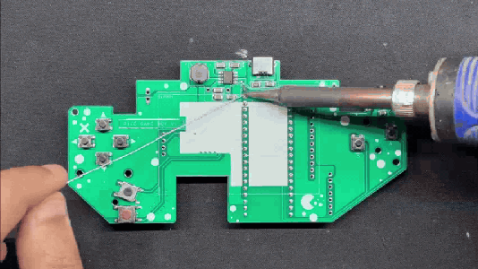

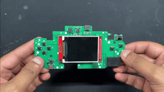

Step 9: PCB Assembly Process

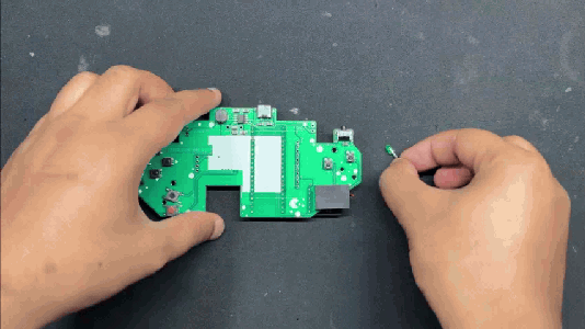

- The assembly begins with applying solder paste to each SMD pad using a dispensing syringe. For this build, we used 63/37 Sn/Pb solder paste, carefully placing it on every surface-mount pad.
- Next, each SMD component is positioned using ESD-safe tweezers, aligning them precisely over their respective pads. Once everything is in place, the board is transferred to a reflow hotplate, which heats the PCB from below until the solder paste melts and secures the components permanently.
- With the SMDs done, we move on to the through-hole components. First, the vertical push button is inserted, followed by the remaining push buttons and finally the USB Type-C port. The board is then flipped, and all THT pads are soldered from the underside to lock the components in place.
- The Raspberry Pi Pico is mounted next—positioned from the bottom side of the board and soldered from the top to ensure a solid connection. We then use a nipper to trim the excess header pin leads, keeping the profile slim and clean.
- After that, the MAX98357 audio module is placed on the bottom side and soldered from the top. Once secured, its leads are trimmed as well. A 3mm green LED is added from the top side, soldered from the bottom, and trimmed to match the low-profile design.
- Finally, the ILI9225 display is mounted from the top side and soldered from the bottom. To wrap things up, a small speaker is attached to the front of the PCB using double-sided tape.
With all components in place and soldered, the circuit assembly is complete.

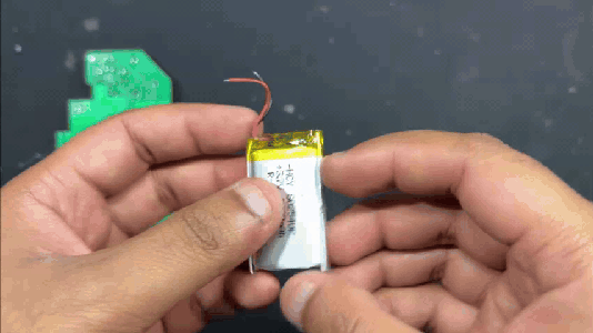

Step 10: Power Source
For PiBoy Advance, we chose a 1000mAh 3.7V LiPo cell as the power source. Its compact size made it a perfect fit inside the Game Boy Advance shell. While we initially hoped to use a higher-capacity battery, space constraints made that tricky. Thankfully, it’s not a major issue—this device draws significantly less power than typical Raspberry Pi-based emulation setups. With the 1000 mAh cell, we’re getting a solid 2.5 to 3 hours of gameplay, which is honestly impressive. It even outperforms my ROG Ally, which barely manages an hour!
The battery assembly process was straightforward. We soldered the positive terminal of the LiPo to the Battery CON + pad on the PCB, and the negative terminal to the Battery CON – pad. To secure the cell to the back of the board, we used double-sided tape and press-fit it into place—keeping the setup clean, stable, and low-profile

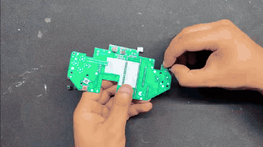

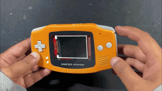

Step 11: Shell Assembly Process

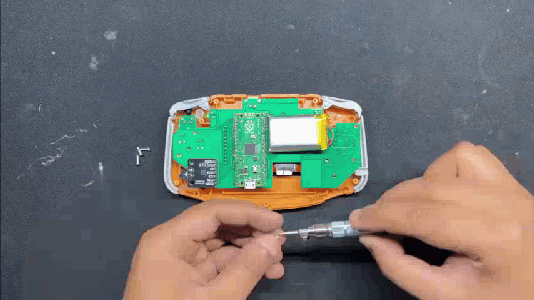

- The shell assembly process, which is the most crucial step in this build, starts with the installation of all the parts included in the GBA Kit to the front half of the body. These parts include the D Pad Button, A-B Buttons, Start-Select Buttons, LED Diffuser, Left Trigger-Right Trigger, and the Left and Right Accent Part.
- The Circuit is then positioned over the screw bosses, and the Circuit is fastened to the Front Body using four M2 screws.
- After that, we position the rear half of the body and fasten the two halves together with six M2 screws, completing the assembly process.
The rear body features an AA cell holder lid. When opened, it provides easy access to the SD card slot and the Raspberry Pi Pico’s USB port, making debugging and updates straightforward.

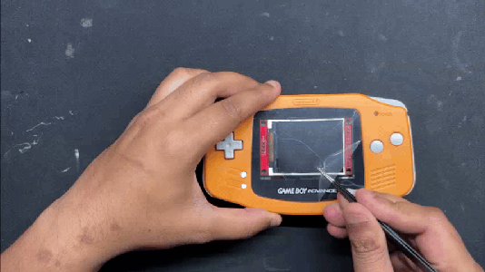

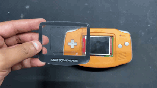

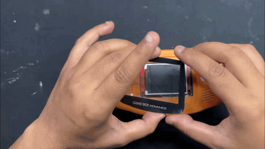

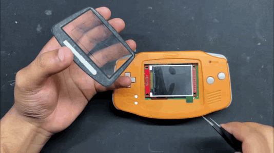

Step 12: Finishing Touches
- We begin by peeling off the back protective film from the double-sided tape on the Front PC Cover provided in the kit.
- Next, we remove the protective film from the ILI9225 display.
- We then align the Front PC Cover with the Front Body and press firmly along the edges to secure it with the Front body.
- Finally, we peel off the outer protective layer from the PC Cover, revealing a clean, scratch-free surface.
With that, the assembly is complete.

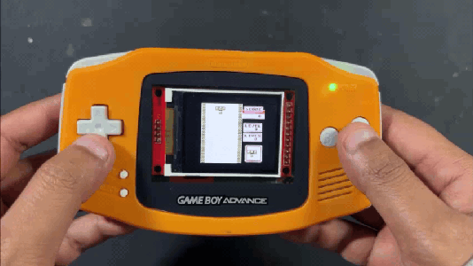

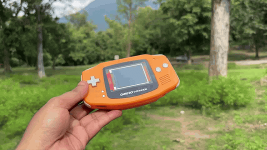

Step 13: RESULTS

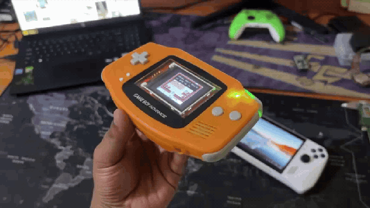

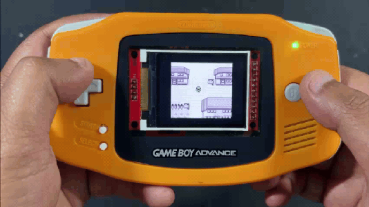

Here’s the end result of this small but seriously fun project: a handheld console that looks just like a Game Boy Advance, but inside, it’s running Game Boy games on a custom-built circuit powered by the Raspberry Pi Pico.
From the outside, it feels like a nostalgic throwback, but open it up and you’ll find a fully DIY setup—a custom PCB featuring the Pico, connected to an ILI9225 display, SD card slot, and audio module, all stitched together without relying on a full-sized Raspberry Pi board.
We ran a bunch of classics, from Tetris to Pokémon to Zelda, and the Pico handled every game flawlessly, without breaking a sweat.
Thanks to the onboard battery, we got a solid 2.5 to 3 hours of backup, which was perfect for outdoor use—we even took it trekking and played a few rounds when we reached our destination.
