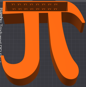

Step 2: Open STL File With Slicer and Position It on Print Bed
Open your slicer of choice (I used Orca Slicer) and drag the STL file onto the print bed. Make sure the Pi is rotated so the compartment faces up, as this eliminates the need for supports.

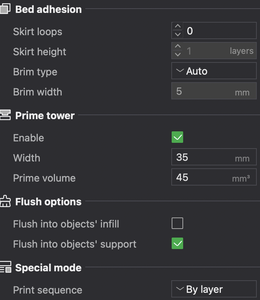

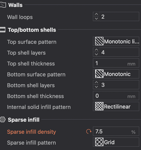

Step 3: Optimize Slicer Settings
The above images are the settings I used for my print profile and balance speed, strength, material usage, and quality. These are the settings I used, however, every printer is different, and you may have different options and controls. If you are using a Bambu Labs P1S printer, below is the exact 3MF print file I used. Otherwise, follow the above information to create your own!
The print does not need any scaffolding if oriented with the Raspberry Pi Cavity facing up.
