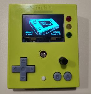

PiConsole is an electronics kit with a Raspberry Pi Pico microcontroller, which has been given the shape of a portable video game console. Once assembled, it can be used for teaching basic electronics and programming activities. And of course also to play.

The assembly of the components is not particularly difficult, as they are all of THT type. The order in which the components are soldered is important, as some are on one side of the PCB and others on the other, so if a certain order is not followed, some solder joints could be hindered. The recommended order is as follows:
- Bottom face PCB (the one with big niubit logo)
- Raspberry Pi Pico: Before soldering Pico to the bottom of the PCB, we have to solder the two 1x20 pin strips to the Pico itself.
- Buzzer
- Upper side PCB
- Resistors
- Schottky diode
- Power switch
- Tactile switch 6mm (reset)
- Rubber switches
- 2x06 socket pin (GPIO)
- IR LED
- Colour LEDs
- LDR photoresistor
- OLED screen with plastic supports
- Bottom face PCB
- Battery holder
- Upper side PCB
- Potentiometer
It is recommended to solder the potentiometer last as it is the component that sticks out the most and is therefore the most obtrusive.
Before soldering the OLED screen, it is recommended to glue or hot glue the nut that will hold the battery holder with the corresponding screw. If we don't do it before, it will be difficult to keep the nut in place to screw the battery holder, as the screen is covering the area.
Despite the screw/nut that holds the battery holder, it is advisable to place a double-layer adhesive strip between it and the PCB, preferably one of a certain thickness, i.e. with foam. It is also advisable to trim the terminals of all the solder joints in this area as much as possible.
In the video of this section you can see the whole process of soldering the components. Unfortunately the audio is in Spanish, but it can be followed without listening to the explanations.
