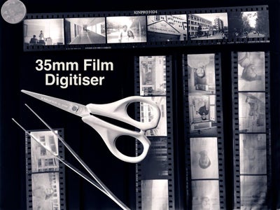

PiDigitiser is an open-source film digitiser designed to bridge the gap for analog enthusiasts and today’s digital workflows. Unlike traditional scanners, PiDigitiser isn’t bound by restrictive hardware or proprietary ecosystems, it is a flexible, DIY-friendly platform that produces high-quality digital outputs of film. By transforming analog sources into easily shareable and manageable digital files, it empowers users to preserve, distribute, and work with their film collections without the barriers of specialized or costly equipment.
Built around easily available components, PiDigitiser is both affordable and accessible. Its modular, open-source nature makes it an ideal solution for a wide range of users: from enthusiasts and amateurs eager to save family archives, to professional archivists safeguarding historical collections, to small businesses seeking a practical alternative to commercial scanning systems. The project not only lowers the entry barrier for film digitisation but also creates space for experimentation and improvement, inviting the community to refine, expand, and innovate upon the design.
In an environment where existing solutions often suffer from high costs, limited availability, or steep learning curves, PiDigitiser provides a more inclusive and adaptable path forward. By rethinking the film-to-digital workflow with openness and accessibility at its core, it aims to improve the current landscape of digitisation and foster a community-driven evolution of film preservation technology.
