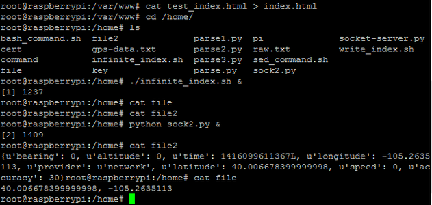

Step 4: Receiving Data on the Pi
- Modify line number 4 of the server-socket.py file with the IP address obtained from step 2.
- Open a terminal window: Run the server-socket.py file using the command: python server-socket.py &.
Now your TCP server is running and ready to collect GPS location data from the Android phone.
Description: The server-socket.py file acts as a TCP server listening on port no. 12345 and receives data from the Android phone (client) and writes it to a file, which is file2 in our case.
Notice the '&'? We use it so that the script runs in the background on the terminal window.

Step 6: Parsing Data and Updating the Web Page
- In a terminal, run parsedata.sh in the background using the command ./parsedata.sh &.
- Now, run infinite_index.sh, which will run write_index.sh and finally, update the web page and display the updated GPS location on the map, every 10 seconds.
Description: The file, 'file2' received from the server-socket.py will have a lot of redundant data which will need to be removed. This will be done by parsedata.sh file which uses a linux golf command - a one liner. Later, we have infinite_index.sh file that runs the write_index.sh file every 10 seconds and update the html web page with the latest obtained location from 'file'.
Note that: The web page is set to auto-refresh every 10 seconds.
