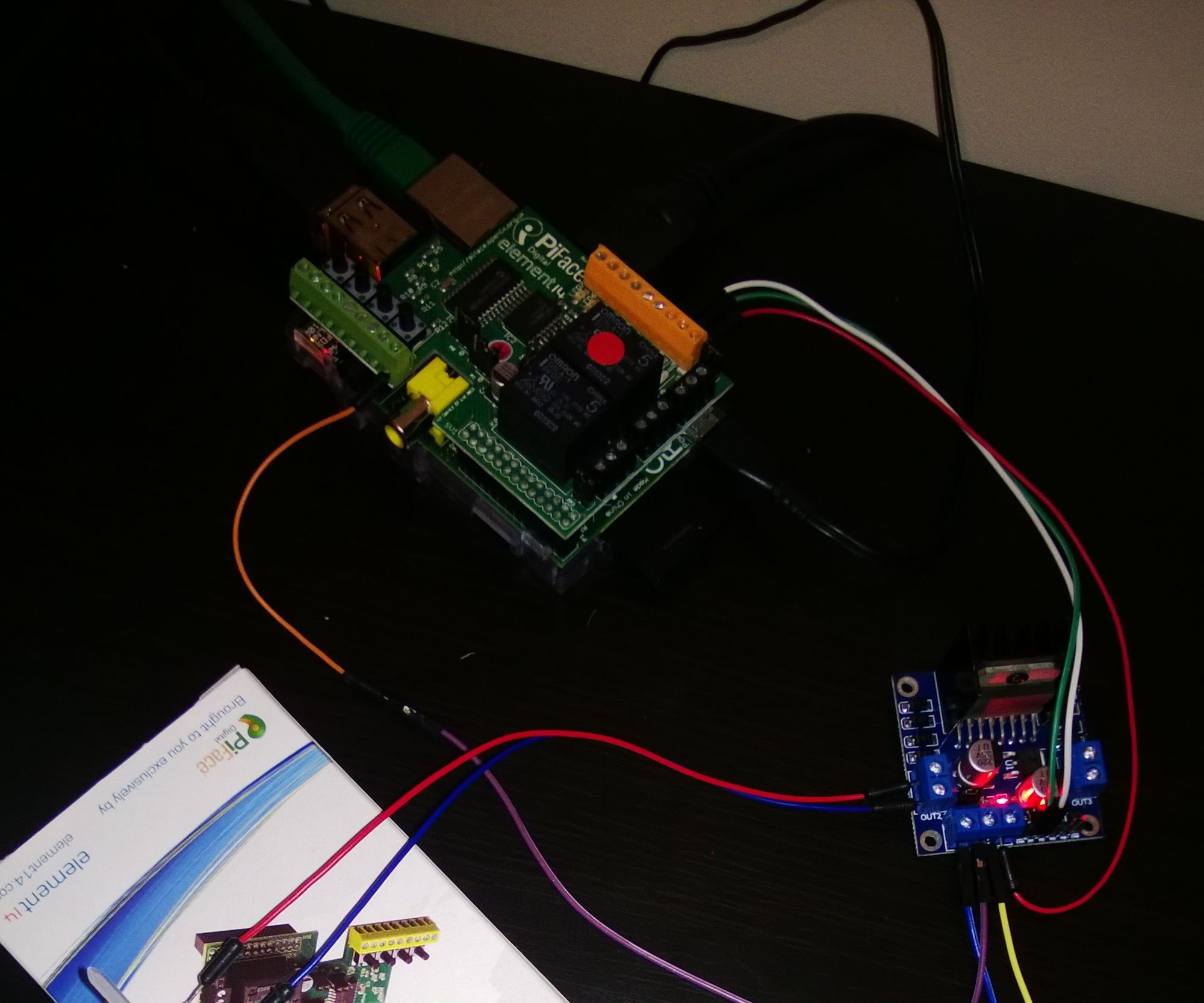

Now you have calculated your resistor value we can put all the components together in the breadboard. The best way to build it will be to follow the pictures but I'll describe what you have to do here anyway.
The blue cable in the pictures is connected to the 5V output on the PiFace and to the long red rail running down the side of my breadboard, I connect the red rail to the blue one using the resistor, the blue rail now has a safe amount of voltage for my LEDs so I can connect the positive terminals (the longer lead) of the LEDs directly to this rail. The negative terminals of the LEDs then need to be connected to separate rows. For each row with an LED in we need to connect a wire to one of the 8 outputs on the PiFace (I have used yellow cables for this), make sure you connect them in order.
Make sure you now connect the 5V output (The output before LED0) on the PiFace to your red rail (the same way as I have my blue cable connected).
You are now ready to turn your Raspberry Pi on.
