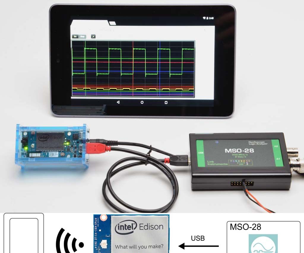

PiMSO, is a Raspberry Pi controlled 200 Msa/S mixed signal oscilloscope. Depending on your application, it can be configure to use the Midori browser on the Pi GUI or access remotely via the internet. Since the PiMSO GUI is web based, You can also control it from a browser on your tablet or smart phone. But what happens when you are at a location that there are no convenient access to a network? For this project I'll demonstrate how to build a Raspberry Pi based oscilloscope that is also a Wireless Access Point.
As a bare minimum you'll need the Raspberry Pi and a Ralink RT5370 based Wi-Fi dongle. For this project I used the Tenda W311M from MicroCenter, primarily because it is Access Point capable and inexpensive. An even less expensive dongle that based on the same Ralink RT5370 chip from Comfast can be purchased from Aliexpress for less than $5 inc S/H. A quick search on Aliexpress for RT5370 should yield a few other options. If you don't have a MSO-28 you can still try it out, the WebMSO28 GUI will run regardless if you have the MSO-28. It'll just show "NO DSO".
If you don't want to roll your own, you can grab a pre-configured Raspian distro from here and skip to Step 6. Otherwise here is how to roll your own on top of your favorite distro.
Update: An Intel Edison based oscilloscope is available here https://www.instructables.com/id/Edison-Scope/

    can i use MSO-19 instead of MSO-28
    0
    tnkrmnz
    tnkrmnz
    Reply 3 years ago
    Try this https://www.linkinstruments.com/wiki/index.php?title=PiMSO19
    Let me know if you have any problems.
