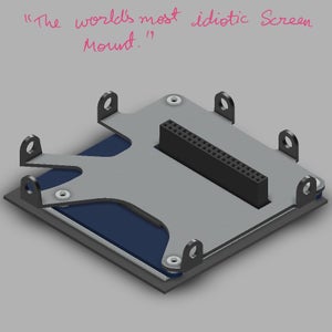

  5. Don't even get me started on probably the most idiotic screen mount designed in the history of mankind. What was I thinking? the screws would have been exposed outside the case and it would have made the case thick and criminally asymmetrical for no good reason.
  6. Moreover my obsession with a freehand internal design meant that the screw holes were too thin, later they were corrected but this idea was a bit of a dog to begin with. ("Idea was a dog" means an idea that is quite dear but not terribly bright.)
This, combined with many other tiny imperfections that needed ironing, I pivoted to Mk.1.

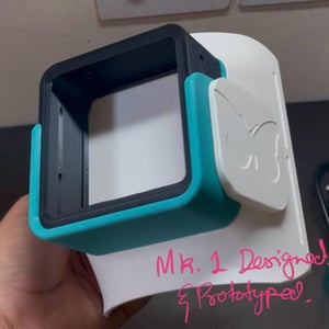

Mk.1 (Codenamed "Mezzanine", after Massive Attack's Album)
The Mk.1 was a derivation of the Mk.0, with some major changes. Here I list out some of the biggest ones.
  1. The straps were segregated into individual slots, rather than trying to accommodate them in one giant four inch slot.
  2. It was the first prototype to feature my butterfly branding.
  3. It now had a vertical slide-in-slide-out mounting that was printed separately so that the layer lines aligned.
  4. The magnets were now complimenting the mechanical clamp of the holder.
  5. The screen mount was now adapted into a sleeved clamp fit.
The Mk.1 was a big ordeal and went through 40 or so revisions before it was scrapped for a number of reasons, here are the big ones listed.
  1. It was TOO THICK, the case was designed in a way there was stacking, and the tolerancing measures made it 15mm thicker than what I wanted.
  2. Due to the way the mount was printed, I could not print both the branding and the holder in a way without either fitment issues or a big ugly gap.
  3. The slots for the straps were still an issue.
  4. This made the case design unusually complicated due to the various tolerance considerations.
  5. At one point the case was to be printed in 3 separate parts (Brim, Body, Back), and for a structural piece, I was not comfortable with that.
  6. This all meant I was overly reliant on superglue, meaning any servicing would have been extremely wasteful and a nightmare.
This made me realise the design was too ambitious and too flawed to continue, so I scrapped the whole thing and made Mk.2.

Originally, the Mk.2 design was supposed to use six 18650 cells. That was the plan, and early calculations showed about six hours of battery life using six 3200mAh cells based on a projected power draw of 2.5A. However, during test fitting, it quickly became obvious there was no way I could fit both the sixth battery and the USB DAC into the case. The spot where the sixth cell was supposed to go, the third battery on the left-hand bank, was just too tight.
By that point, I had also realized that my original power consumption estimate was way off. The PiPod, in real-world use, was drawing closer to 700 mA — nowhere near 2.5A. With that in mind, I recalculated the battery life, and it turned out that even with just five cells, I was looking at around 18 hours of runtime. At that point, it made far more sense to just lose a battery than to redesign the case this late in the build.
And then, I failed, AGAIN. :'(
The five remaining batteries were still mounted on the back of the case, not inside it. When the back panel was empty, it had a nice bit of flex and compliance. But once I stuck the battery holders on, it acted like a rigid spine, and the compliance was gone. That rigidity led to me breaking the back panel. Luckily, I remembered I still had the dual 18650 holders from my earlier PiPod Mk.0 design, which originally used a stacked dual carriage battery layout. So, in a moment of desperate improvisation, I retrofitted those holders into the Mk.2 design. It wasn’t planned, it wasn’t neat, but DUE TO SHEER DUMB LUCK, IT WORKED.
Now, the Mk2 case itself had to be redesigned a bit to accommodate the dual holders. Even the back of the case was redesigned to make it all fit properly.
I thought I didn’t have enough filament left over to finish printing what was effectively the final case for the PiPod. The first print had failed because, FOR THE FIRST TIME EVER, the printer nozzle got clogged. I’d never dealt with a nozzle clog before. Turns out, it happened because there were specks of black material in the marble filament.
I was genuinely panicking because I wasn’t sure if I had enough filament left to fix the case or print a new one. But, in a moment of genius disaster, I realized that the half-printed, failed case was actually useful. It was perfect to measure the tolerances for the new, retrofitted dual packs because it was literally a section of the case. It allowed me to get into tiny crevices and spots I wouldn’t have been able to reach otherwise. And, as fate would have it, there was just enough filament left to finish the final print of the case.

  1. First and foremost, insert all the brass inserts in the photographed places. If you do not know how to work with brass inserts, Click Here.
  2. Do the screen mount now, take your time, ensuring that the sleeve fits the screen, the screen is properly seated on the middle layer and there is no extraordinary and unnecessary friction.
  3. I would suggest you do the middle layer assembly and screwing now. That includes the battery management system and the USB-C breakout as well as the USB DAC using M2.5 x 6mm screw screws.
  4. Now seat the screen on the middle layer delicately and use M2.5 x 10mm screws to anchor it until snug.
  5. Clip a part of the bottom most layer of the screen mount as shown in the picture.
