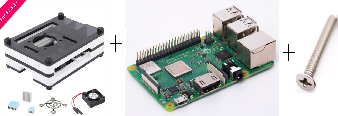

Step 1: Case Assembling
I started by assembling of acrylic case with fan to Pi3B+ using screws 2.5mm x 25mm. Fan' existence is important as it will cool down Pi.

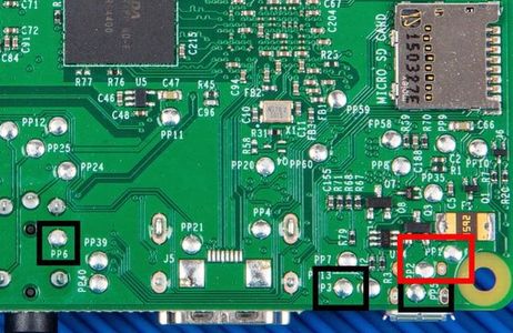

Then I soldered wires to probe points at back of board Pi3B+ named PP2 for further ( not now ) connection to 5V positive power supply and (PP5 or PP6) for 5V negative power supply, about 10 cm long.

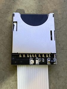

Step 3: Prepare SD Extender

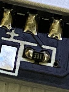

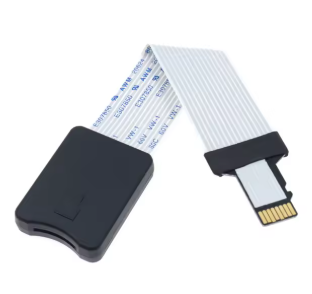

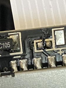

Then I prepared SD card extender 25 cm long. Initially SD card extender does not work, and I found that it is common problem and is solved by desoldering one resistor of 330 Om.
https://forums.raspberrypi.com/viewtopic.php?t=269457
https://forum.arduino.cc/t/micro-sd-extender-cable-not-working/958431/7
Then I connected SD extender to Pi and folded cable so that only SD case was out of Pi.

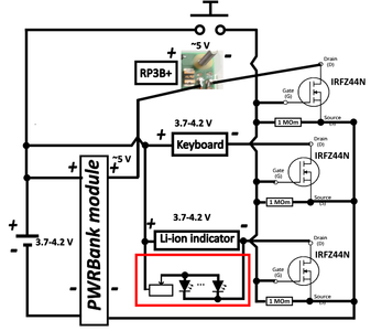

To power Pi/Keyboard/Li-ionindicator I used IRFZ44N MosFET, although Gate threshold voltage is 2V-4V at the datasheet, practically at 1.5V the Drain current is 10-20mA, and all electronics work fine even at 3.0 volts at Gate, but practically Battery voltage won't decrease lower than 3.3V.
At the diagram, I represented how I connected each electronic component.
I inserted a wireless Keyboard USB stick to one of four USB ports to establish communication between Pi and Keyboard.
For keyboard, I disconnected an internal battery, and left MosFET inside of Keyboard.
All MosFETs and soldered joints were covered by hot glue to prevent short-circuit.
For other Raspberry Pi versions 4/5, the Gate voltage should be supplied from some Buck converter at least 5v, because Pi 4/5 current consumption is bigger.

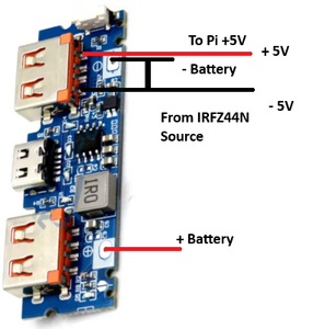

Next step is putting the powerbank module and USB extenders in appropriate holes and connecting battery ( 10Ah for now) to powerbank module.

PiUniDeck can be used as PowerBank due to PowerBank module usage.
