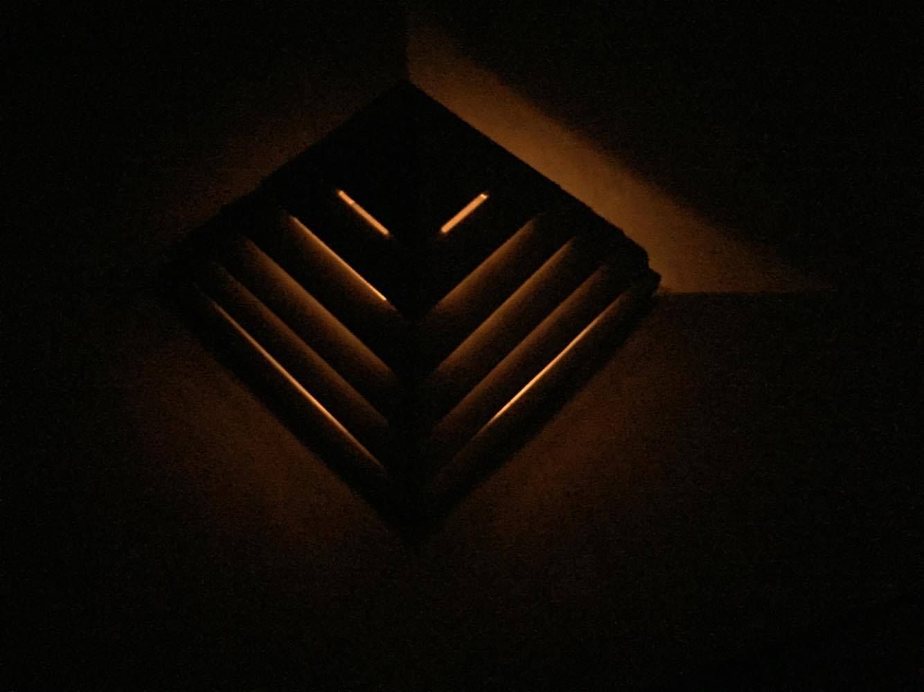

Step 5: Building the Frame
you can skip this step if you've build your own shelter for the pi and its wiring. Be aware that my frame is build out of a metal which means it conducts electricity !!
I started with an inox plate and cut out 4 triangles. Next I've cut out the border of each triangle. The border will be used as skeleton for the whole construction.
Take the four borders and bring them together so they'll take a shape of a pyramid. After welding the four borders together I've added 3strokes to the bottom of the borders. The strokes can hold a plate that will fit as foundation.
Once the skeleton is done, take the 4 triangles and cut them into strips. Now welder the strips under an angle of 30degrees. I suggest you start from the bottom and end at the top.
After the shelter is build we can go on and place the raspberry pi and the wiring. I started with the LRD. I taped off the two legs of the sensor so electricity won't conduct via the inox. Then I used two thermoplastic connectors the wire the LDR on the breadboard.
The next step I did was taping of the leds. I used super glue to make sure the leds will stick to the ceiling of the pyramid.
The last hard part is placing the rain detect module sensor on the pyramid. I've used again super glue but only on the black borders of the sensor otherwise the sensor will "detect" rain that isn't there.
