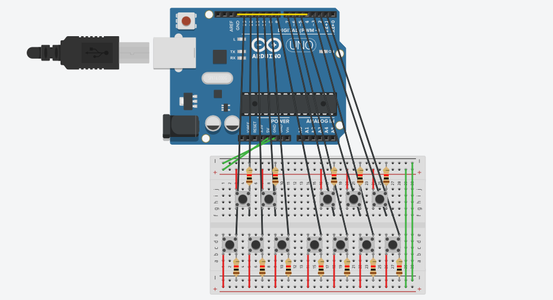

  • Arduino board
  • small button x12
  • 120 Ohm Resistor x12
Step 1: Set Up the Circuit
You just need to connect the button to D1 to D13, except D4. D4 needs to connect with GND.
Step 2: Uploading the Code

At the end of the code, I have marked out which pitch is it belong to.
I have a problem up here, I still can't found out and correct it before the deadline for my H.W.
The problem is that there has some button you can't send out the letter I want it to have. Some of them can send it out, but they will send out the wrong letter, or just didn't send anything out. Oh, and they will delay some time.
If you can, please help me fix out this question. 🥺
