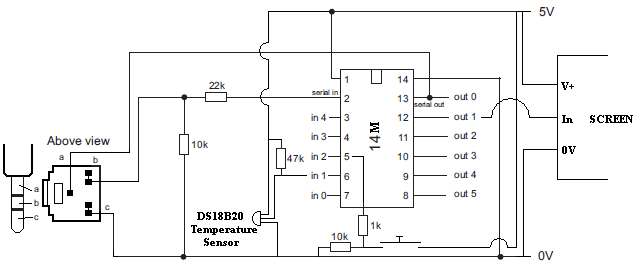

The finished circuit and circuit diagram are pictures below or, if you aren't a member, on the last two pages.

Step 1: Connect Battery Pack
 Step One: Connect the battery pack to the two outside tracks on the breadboard.
Step 2: Plug in Chip
 Step 2: Plug the Chip in, roughly in the centre of the board, so that the legs are on either side of the gap down the middle.
Step 3: Connect Power to the Chip
 Step 3: Connect the first leg away from V+ on the chip to V+, and the 0V opposite to 0V. .
Step 4: Make the Programming Interface
 Step 4:
Cut the verro board so that the tracks are running lengthways.
Solder on the stereo plug so that it slightly overhangs the edge.
Solder in the 10K resistor between the two outside pins on the stereo plug.
Solder the 22K resistor between the right hand pin and a spare track.
Solder three wires, one to the middle pin on the socket, one to the end of the 10K resistor and one to the end of the 22K resistor.
Step 5: Plug in the Programming Interface
Step 5:
Connect the wire form the centre pin to the serial output.
Connect the wire from the 22K resistor to serial input.
Connect the other wire to 0V.
Step 6: Connect the Temperature Sensor
 Step 6:
Plug the sensor into the breadboard with the rounded face pointing out.
Connect the right hand leg to V+.
Connect the left hand leg to 0V.
Connect the middle leg to input 1.
Connect the 47K resistor from the same pin on the chip to V+.
Step 7: Connect the Switch
 Step 7:
Plug one end of the switch to V+.
Connect the other end to 0V with a 10K resistor and input 2 with a 1K resistor.
Step 8: Connect the Screen
 Step 8:
Connect a wire to the pads marked "In", "V+" and "0V" on the screen.
Connect the V+ and 0V to, you'll never guess, V+ and 0V.
Connect the In wire to output 1.

Step 12: Circuit Diagram
(For non-members!)
Step 13: Finished Circuit
