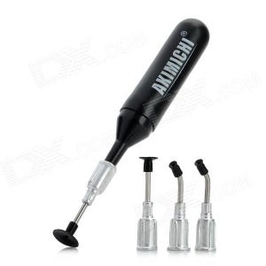

- Akimichi vacuum pen (order it online: link) > €3

Step 19: Connect Vacuum Pen Head
Take on of the twisted heads of the vacuum pen and slide it over the other side of the straw. It should fix itself.
Pick one of the two largest suction cups and place it on top of the head.
