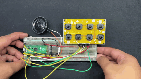

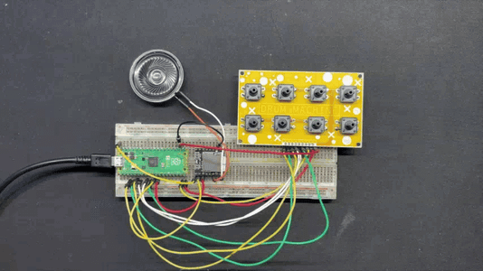

  1. Let's start the wiring process of this project, which was quite straightforward. We first connect the GND of PICO2, DFmini player, and Switch board together.
  2. Next, we connected the VCC of the DFmini player with PICO's VBUS terminal.
  3. The first switch connected to GPIO14, the second to GPIO15, the third to GPIO16, the fourth to GPIO17, the fifth to GPIO18, the sixth to GPIO19, the seventh to GPIO20, and the eighth to GPIO21.
  4. The speaker is connected to the DF player's Speaker 1 and 2 pins.

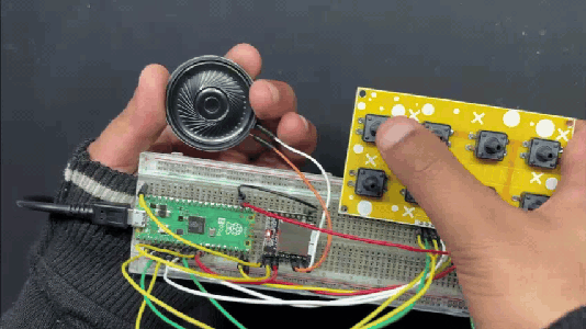

A functional drum machine that plays audio files when any of the eight buttons are hit is the final result of this little project. Each button corresponds to a single audio file saved on the SD card; when we push the button, the audio track is played. We have released a YouTube short that you may view; it demonstrates a testing video of the setup.
Using this arrangement, we may connect several buttons to increase the amount of files or fully replace the audio files with other instrument audio files. This project may be used to create a piano instead of a drum set, a flute, a harmonium, or a violin.
