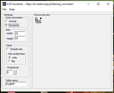

Step 2: Convert Your Image to Bytes
Start LCD Assistant and open the file you just created.
Set orientation to HORIZONTAL, Size endianness(?) to Little and Pixels/byte to 8
Save Output as a txt file ie Image.txt

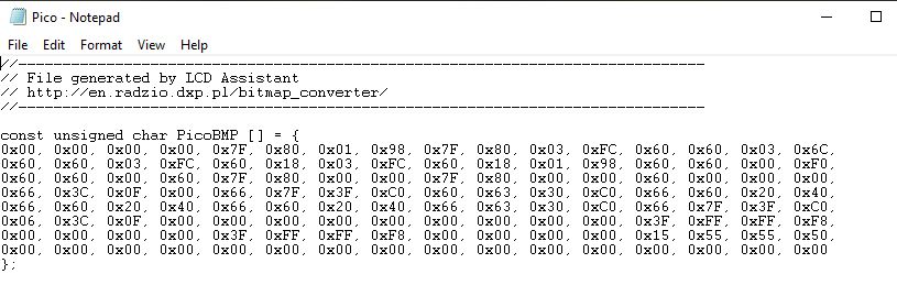

Step 3: Edit the Data
Open the file in NotePad
This now needs a bit of editing:
Copy the block of code starting const and paste into the code under the buffer definition in Thonny.
Delete the semi colon at the end. Change the braces {} to brackets ()
Find and replace ‘ , 0’ ( -- comma space zero) with \
Edit the start of each line and replace the initial 0 with a \
Delete the commas from the end of each line.
Insert b” after the opening bracket and “ before the closing bracket.
Insert bytearray between the = and the bracket
Delete the newlines to make a single very long line starting:
buffer4 = bytearray(b”\x00\x ………… “)
Carefully compare the syntax with the original buffer line. (The original Raspberry code has some ‘funny’ characters. The new code should be consistent in its format: \xNN\x…)
