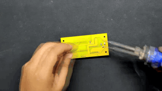

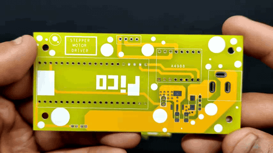

After creating the schematic, we prepared the board design and then exported the Gerber data, which will be shared with a PCB manufacturer.
Step 2: HQ NextPCB Service
After completing the PCB design, we export the Gerber data and send it to HQ NextPCB for samples.
Gerber Data was sent to HQ NextPCB, and a Yellow Solder Mask PCB with White Screen was ordered.
After placing the order, the PCBs were received within a week, and the PCB quality was pretty great.

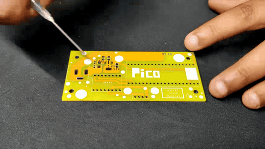

Step 4: Circuit Assembly Process

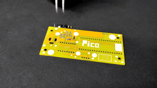

  1. We begin the circuit-built procedure by utilizing a solder paste dispensing syringe to add solder paste to each pad of the SMD components. In this instance, the 63/37 Sn/Pb Solder paste, which melts at the temperature of 190° Celsius, is being used.
  2. We next pick and place each SMD component in its proper location using an ESD Tweezer.

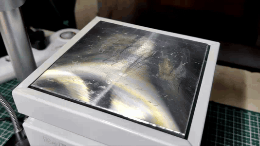

  3. All SMD components are then permanently soldered to their pads when the entire circuit board is placed on the reflow hotplate, which heats the solder paste to its melting point.

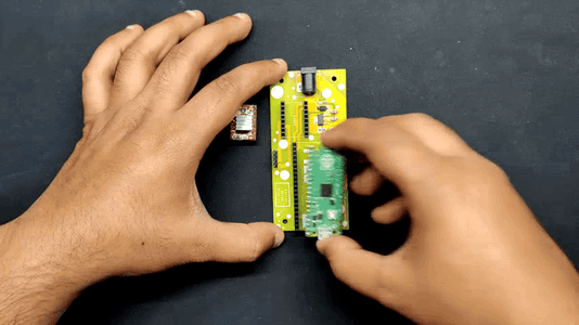

  4. The THT components, such as the male header pin, female header pin connectors, and DC barrel jack, are then positioned in their proper positions, and their pads are soldered with a soldering iron.
  5. After that, we position the A4988 Motor driver in its proper location and place the Raspberry Pi Pico on the female header pins.
Circuit assembly is now complete.

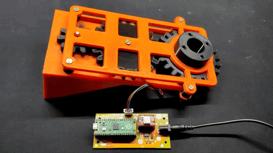

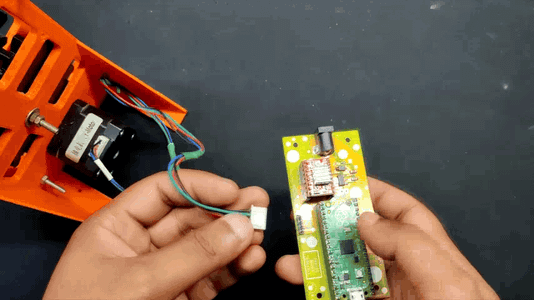

Step 6: STEPPER MOTOR SETUP

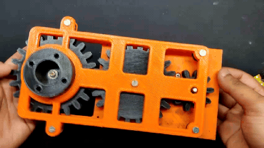

We developed a gearbox for the stepper motor test, which will be used in a future project. This driver circuit is just a part of that project.
  1. A gearbox with three gears—two 22-teeth gears with a 5mm modulus and one 10-teeth gear with the same 5mm modulus—is included here. We used a Nema17 stepper motor that we salvaged from an old Anet A8 3D printer to connect the smaller 10-teeth gear.
  2. We connected the stepper motor's wire harness connector to the driver's CON4, which is connected to the A1, A2, B1, and B2 terminals of the A4988 driver.
  3. The motor begins to rotate when the device is switched on by plugging the DC jack of a 12V 2A power adapter into the circuit via the DC barrel jack.

This small yet practical project has resulted in a Stepper Motor Driver Board that can run almost any stepper motor. It is powered by the Pico and only needs a 12V input. Theoretically, we could just replace the A4988 Motor driver with another Stepper Motor driver board because most of them have the same footprint.
The Onboard Raspberry Pi Pico makes things incredibly easy to control; we can just connect the Pico with our computer and edit the code, make modifications, and then drive the motor with the 12V power adaptor.
