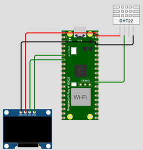

Step 1: Design the Circuit
Step 1: Design the Circuit (WOKWI)
  1. Open the WOKWI project: Click Here
  2. Review the pin connections:
  3. DHT11 to GPIO 15
  4. SSD1306 (SCL to GPIO 1, SDA to GPIO 0)
  5. Power and ground appropriately wired

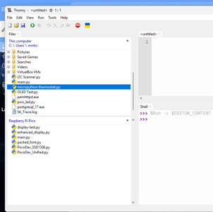

Step 2: Flash the Code to Pico
  1. Install Thonny IDE
  2. Connect your Pico via USB
  3. Upload the MicroPython code (see code section below)
  4. Verify temperature and humidity readings appear on the display
I am unable to upload the font files with current extention (.pf) So I have renamed them to (.txt)
You will need to rename them back for it to work properly
