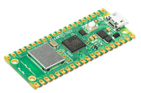

Raspberry Pi Pico WH (WiFi with Headers)

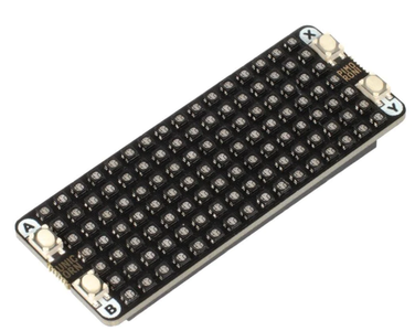

Pimoroni Unicorn Matrix Pack

If you have never worked with a Pico before - there is a great and easy tutorial here:
https://learn.pimoroni.com/article/getting-started-with-pico
Download the custom Pimoroni PicoW Firmware (make sure to get the "W" one): pimoroni-picow-v1.20.4-micropython.uf2 from here: https://github.com/pimoroni/pimoroni-pico/releases
Push the Unicorn Pack firmly onto the headers on the Pico - making sure you get the orientation correct.
Push and HOLD down the Boot Select button while hooking it up to the USB port on your PC, this should open a file explorer window, now drag and drop the UF2 file into the window. Once the file is copied the Pico will instantly reboot with the new firmware.
