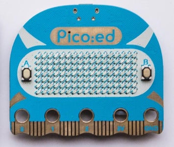

Step 1: Differences Between V1 and V2 - Front
The face appears very similar with a 17x7 LED display, two buttons, connections along the bottom edge, now scalloped, rounded top corners and a less severe colour pallet, probably to give a greater appeal to girls. The Built in LED on pin P25 remains in the dot of the ‘i ’in Pico.

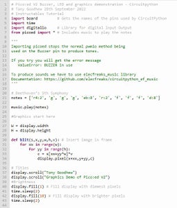

Step 8: Basic Tones and Scrolling
The necessary libraries are imported, and a few notes are played. (You need to use the music library to send tones to the built-in buzzer as picoed library takes control of pin P3, connected to the built-in buzzer. You cannot use pwmio to generate tones for the built-in buzzer.)
The width and height of the display are saved and a short procedure, blit(s,x,y,w,h,v) is defined. (It helps to copy a small user defined image to the display.)
The titles are scrolled across the display and then the display is set to different two brightness levels. If the string to be scrolled is 3 characters or less, it remains stationary, but if longer it scrolls.

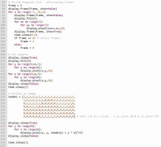

Step 10: Part 3 -Diagonal Line, Squares and Image
The instruction display.pixel(3,4,20) lights up the 4th pixel from the left in the 5th row with brightness 20. (Computers count from zero.) They change immediately. I soon noticed that as you turned pixels on and off you created a rippling effect across the screen and occasional random and irritating flashes from parts of the screen you were not writing to.
The documentation suggests that you use display.sleep(True) to turn off the instant updating while you change pixels and then expose the changes with display.sleep(False) when you have finished the changes.
You can also write to different screen buffers, or frames, numbered 0 - 7. I found that using frames and the corresponding display.frame(frame, show=False) and display.frame(frame, show=True) worked very well in suppressing the screen jitter.
In this section we see a moving diagonal line, a screen full of squares and a simple method of creating and displaying a full-screen image - sunglasses. (I think this method will be easier for children to understand than the list of hexadecimal numbers representing the 17 columns used by Elecfreaks.)

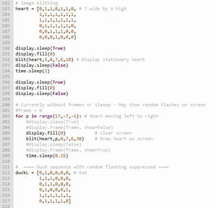

Step 12: Part 5 - Defining & Moving Small Images
Here a small heart image is defined and the blit(s,x,y,w,h,v) procedure, defined earlier, is used to position in the display. Initially it is stationary and then it moves across the screen.

I have commented out the jitter suppression - which does not appear to be too intrusive here.

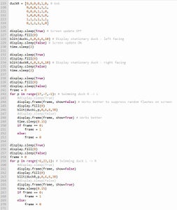

Step 13: Part 6 - Swimming Ducks
Stationary and moving ducks. They are smaller at 6x6 than the heart with 6x7 pixels.

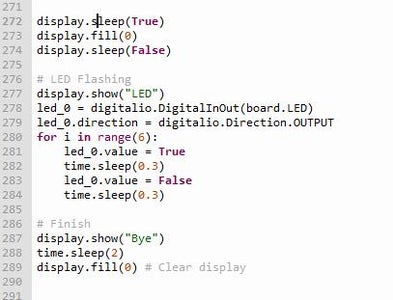

Step 14: Part 7 - Flashing the Built-in LED
The built-in LED is flashed, and stationary text displayed before clearing the display.

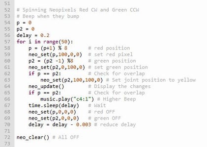

Step 17: Part 2
This sets red and green pixels apparently rotating in opposite directions - making yellow when they overlap and emitting a beep. They speed up as time passes.
After 50 steps the rings clears at the end of the program.
