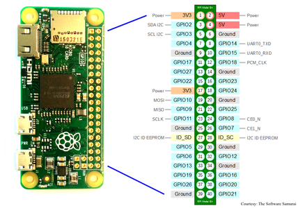

Soldering Header Pins to Pi Zero W:
  1. Gather your Pi Zero W, Soldering Kit, and GPIO Male Header Pins.
  2. Place the shorter end of the Header Pins through the front of the Pi Zero W. *Picture 1
  3. Carefully solder the 40 pins with your soldering iron kit. If you have never soldered before, I suggest that you take a look at this awesome guide (includes a great video for beginners): https://learn.sparkfun.com. *Picture 2
  4. Keep your soldering iron for next step. However, disconnect it if you don't have the next setup's materials.

  5. Connect the Jumper Wire that is soldered to the short lead of the LED to Pin 6 on the Pi Zero W. *Picture 7 for reference
  6. Cleanup after you are done soldering. The soldering equipment is no longer necessary.
  7. Power the Pi Zero W with the Micro-USB.
  8. Connect the other Jumper Wire to Pin 2 on the Pi Zero W. The LED should light up! YEAH!
  9. Disconnect the Jumper Wires connected to the Pi Zero W and the Micro-USB.
  10. Keep all these materials for the final setup.
