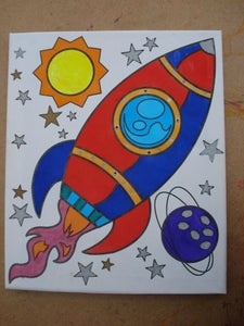

Step 1: Design and Decorate Your Canvas
Decide on your design and where the controls will go. We used small metal nuts as the controls and these act as decoration for the picture as well as being functional.
Makey Makey has 6 inputs that can easily be connected via crocodile clips so 6 controls is a good number to choose.
We included controls for:
- Up, down, left, right - placed around the rocket window
- Boost - towards the bottom of the rocket
- Fire - towards the top of the rocket
Decorate your canvas, making sure you think about where the controls will be placed.

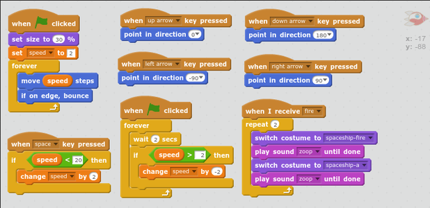

Step 4: Write Your Game
Now you can write a game for your Picture Frame Controller. We used Scratch 2 online. You can use or remix the Makey Makey Rocket project.
Makey Makey simply sends key presses and mouse events and it's easy to respond to those events in Scratch.
Most of the code is added to the Spaceship sprite and is triggered by 'When Pressed' events.
Note that to respond to the Mouse Click event you will need to add a script to the Stage and use the 'When Stage Clicked' block (sprites have a 'When This Sprite Clicked' block and that's not what we need here.)
