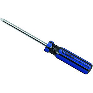

Screwdrivers: Pozi and Phillips (Cross and flathead)
Pozi Screwdriver

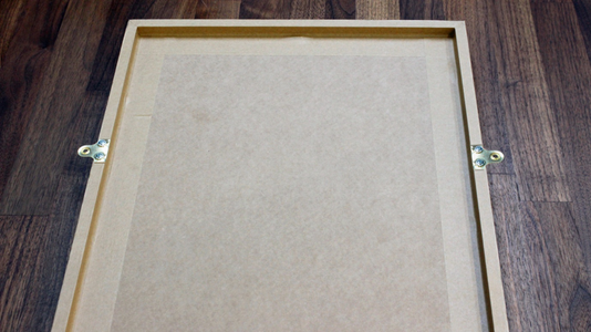

Step 3: Frame
Take your frame apart and remove the glass.
Cut the hardboard the same size as the piece of board that goes behind the picture in the frame and glue them together. This strengthens the board and takes up the space lost by removing the glass, without it the frame may rattle.
Lay out your tools where you want them to go. The claw hammer handle was too long to fit in the frame, so I cut a small amount off the bottom. I sanded the handle and oiled with Linseed oil, but this isn't necessary if you happy with how the hammer looks.
You need to decide how you want to attach the tools to the frame. I used the 19mm tool clips for the screwdrivers and hammer. Mark where these will go so you can drill a 4mm hole through the back board to rivet or bolt them on. The 19mm clips seemed right for the tools I used, if your not sure measure the tool with calipers.
For the radiator key I used the L hooks, these need a 1-15mm hole drilling through the back board.
I used the magnet to hold the Superglue in place

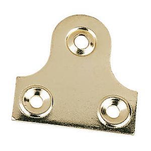

Step 6: Hanging
If mounting to a wall I would recommend picture mirror fixing, so it can be screwed to the wall. A tiny picture hook may not take the weight and it may fall off the wall every time you remove a tool.
Picture plates
These screw into the back of the frame and a screw mounts to the wall
I didn't attach these to mine, being a gift I thought I'd let the recipient decide how to mount it
