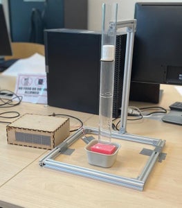

Step 2: Creating the Stand From Alluminium Extrusion
To begin step 2, all the necessary items were gathered. In our case we needed 4 item profiles of 30 cm, 1 item profile of 40 cm, 1 item profile of 20 cm, 22 bolts, 21 T-slot nuts, 9 angle brackets and 2 straight brackets.
When all the items are gathered one can start by assembling the bottom square, from now on called the base. This can be done by using 4 angle brackets, 8 bolts and 4 pieces of extrusion of 30 cm. First place the T-slot nuts in the holes on the side of the pieces of extrusion. It is important to make sure that the T-slot nuts are proparly inserted into the slots, otherwise you cannot properly attach the piece of extrusion to each other with the screws. To tighten the pieces of extrusion firmly, it is recommended to use an Allen wranch, as this tightens the bolts more firmly. Furthermore it is smart to first loosly tighten the bolts and then when the pieces of extrusion are in the right place tighten them.
Next add the piece of extrusion of 40 cm in the center of one of the sides of the base perpendicularly. Use herefore 3 angle brackets and 6 bolts.
Last of all add the 20 cm piece of extrusion perpendicularly to the top of the 40 cm piece. Use 2 straight brackets, 1 angle bracket and 6 bolts.
The final result should resemble a sort of 'hangman' setup as shown in the images.

Step 4: Creating the Electronics and Housing.
In order to create an entertaining setup, we will create a LED strip display showing the piezo electric effect. In order to hide the electric components (arduino, wiring, etc) we will first create a small housing from lasercut plywood, after which we can hide the arduino.
Step 4 begins with designing a wooden box to fit all components inside. Using the makercase website, we create and download the box. The box must be able to contain the following items:
  1. Small breadboard
  2. Arduino Uno
  3. LED Matrix MAX7219 Module
  4. Wires
  5. Battery (9V), powerbank or socket
Given the parameters of these items, the inside of the box should be about 17 x 12 x 7 cm. After downloading the schematic, manually create a 12.9 x 3.3 cm slot in Inkscape or any other editing program. The first two images show the unglued vs glued box. Make sure to not glue the top of the box, otherwise you might lock up your arduino!
As for the electronics, we only need to connect two 'components' to the arduino. Easy enough, right?
First, the LED matrix. Notice how it has 5 pins sticking out of the edge. We need to connect them like this:
  1. VCC --> 5V
  2. GND --> Breadboard common ground
  3. DIN --> pin 11
  4. CS --> pin 3
  5. CLK --> pin 13
This might sound confusing, so you can also follow the colored wires from the attached image. If you do it this way, make sure the black wire (ground) is connected to the breadboard, since we need a few more wires attatched to ground. If this is still too difficult, you can also follow this guide website, providing a detailed overview of how the LED matrix works (as well as some fun examples!).
After this, we connect the piezo positive (red wire) to the A1 pin of the arduino and the piezo negative (black wire) to the common ground. Then the final step is connecting the common ground to the arduino GND pin, and voilà.
As for the code, download the file named Led.ino. If you use the Arduino IDE app, you can upload this code to the arduino, and it should then function properly.
After this has been set up, you can put all the electronics inside the wooden box, and connect the piezo wires through a hole in the corner. Electronics and housing, check ✓ !
Step 5: Putting It All Together
To assemble everything together, we first need to make the set up of the tupperware. We used a tupperware, 10 by 10 cm, inside there were 2 layers of filt then the piezo element was attachted to the top of the filt and then 1 layer of spons was added. This is all to make sure that the mass will not break the piezo elements and that the Arduino will not explode.
For the mass we used a 3D printed white box which was made of 20g of pla filament.
Now that everything has been set up, there is only one step remaining. One simple step: put the piezo, which is in the tupperware underneath the drop mechanism. Make sure that the piezo element is right underneath the drop machanism, to ensure a stable ouput. Really, thats all. It should just work if you load the drop mechanism up and trigger the piezo. However, if there is trouble, here is a list of common mistakes and how to fix them.
  1. The display doesn't show a reading --> seperate the drop mechanism and the electronics+housing and check for the following: are the wires set up correctly? Make sure they are on the correct pins, and are firmly connected. Check if the piezo plus and negative are not mixed up. Finally check if there is a voltage source connected to the Arduino (either a battery or a power socket).
  2. The dropped weight doesn't fall on the piezo element --> try to move the plexiglass tube a bit to the side, to make sure it is centered above the piezo element.
  3. The display always fills up completely --> place some foam above the piezo element to lower the impact of the weight falling on it. This should reduce the volts produced.
If everything now functions properly, you should have a wonderful physical demonstration that shows the transfer of kinetic energy into electrical energy.
