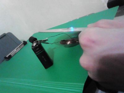

Step 1: Building Device
Transmitter coil
Took enameled magnet wire, and wrap it around toilet paper roll, beer can, or something similar ( about 3 – 5 cm in diameter, don’t make it bigger, because buzzer use low current, so bigger coil will not work properly).
First let some 5 centimeters of wire free, for connection, and start to wind magnet wire on empty paper roll. Wrap wire of the coil in one, same direction. Wind about 30 - 40 turns of wire, then left some free wire on the end, and you finish your coil.
Careful remove your coil from paper roll, firmly holding coil, then wrap free coil ends perpendicular around coil, few turns is sufficient. Add a drop of super glue on coil.
Next, you have to clean ends of enameled wire, remove isolation using scalpel.
Connect buzzer to the coil
Connect wire from one side of the coil to one buzzer lead (longer lead is positive) simply wrap wire on it.
Cut another piece of wire, about 10 cm, and remove isolation from its ends. Wrap it around second free leg of buzzer (shorter one – negative).
Attach alligator clips, or battery adapter on the free ends of wire – one is coil end, and other is from the buzzer lead.
Receiver
Receiver is just simple coil of wire. I’m using one from my earlier project. It is attached on CD, to support it, just because I’m used very thin wire from old, salvaged transformer.
Took enameled magnet wire, wrap about 30 - 40 turns, it should be similar size with transmitter coil. You should also wrap your coil in same direction as transmitter coil. Strip insulation from both ends of coil and connect led diode to ends or receiving coil.
Glue everything.
Step 2: Add Power...
Connect to the battery
Now connect your battery to your device. The buzzer is making loud noise...
Took receiver coil, and get it near to transmitter coil, led should emit light, as you get closer to the coil.
If the sound is unbearable (after some time, it will be...), you could glue a piece of sponge to the top of buzzer, it will reduce torment...
