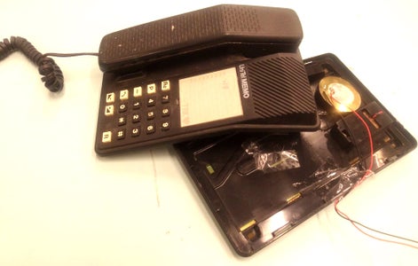

Did you know that you could use the speaker in an old phone to detect if someone is knocking on your door? Here we will explain how Piezos work and give some examples of how they could be used.

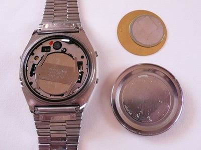

Inside the Piezo, there are crystals. These crystals are normally in electronic equilibrium. However, the moment the Piezo starts to vibrate, the crystals are no longer in equilibrium, and they emit a small electric charge. This effect is called piezoelectricity. The more vibration, the more voltage it emits. This ability is used to detect vibration by reading the voltages coming from the Piezo.
This phenomena also works in reverse. By sending small voltages to the Piezo, the crystals will start to vibrate and make soundwaves. This means that the Piezo can be used as both an input, detecting knocks, vibrations and sounds, and also as an output, making sounds.
Step 2: The Different Types of Piezos
There are many different ones, but they generally work in the same way. We have been looking at these different sensors. Basically, the difference between them is what direction you mount them, and the direction of the vibrations you want to detect. Also, some of them are a bit more sensitive others. The ones with the thin film detect vibrations perpendicular to the film, and these could also be used as accelerometers.

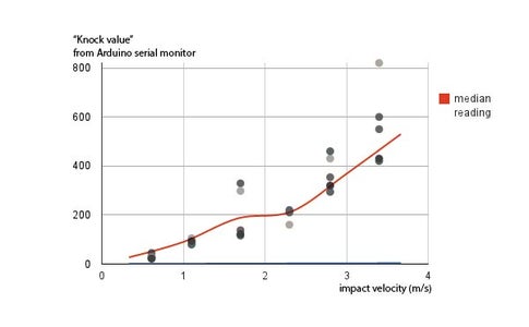

We did a lot of testing to find the relationship between the force applied and readings from the arduino, but the results seemed very unstable. We tried smoothing/averaging (link to code) the readings, but the results still seemed very little accurate, and at times completely random. We also used a potentiometer (link) to vary the threshold above which readings were recorded, but it did not help with stabilizing the readings.
One knock takes place over a period of time. As we used little or no delay (1 millisecond), we read several values in one knock. The values showed in the points in the graph above is taken by adding together all the different readings from one knock. The readings could be all whole numbers between 0 and 1023, and a typical reading was (0, 200, 65, 2, 1, 0), creating a value of 268 in the graph.
An important factor in registering the values, is the amount of time from the beginning to the end of the knock. If you apply a large amount of force to the sensor, but in a long a mount of time, the registered voltage values will still be small. If the impact takes place over a short period of time, the values will be higher.
Conclusion of tests: The sensors are not very accurate. They should be used to detect that a knock has taken place, rather than the amount of force used in a knock. That is, unless you are looking for an average of the readings of several knocks with the same force and impact duration.
According to the manufacturers of our sensors, the relationship between the applied force and registered voltage is linear. However, from our experience, the accuracy does not seem to be very good.
