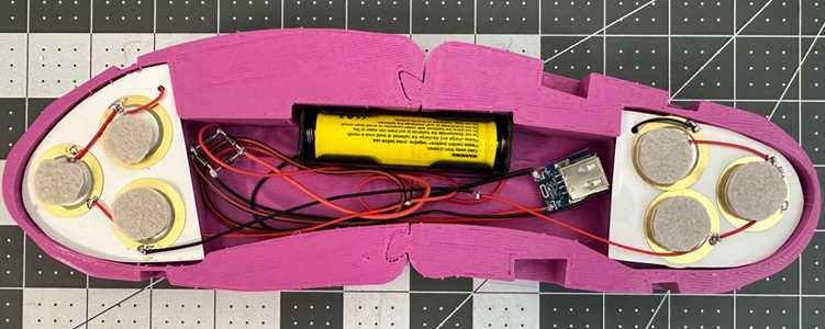

Integrates piezoelectric sensors into 3D-printed shoe soles to harvest energy.
Converts mechanical energy from walking into electrical energy.
• Energy can be stored in batteries or capacitors to power devices like fitness trackers and smartphones.
• TPU-based 3D-printed housing ensures comfort and durability.

  1. 12 x 27mm Piezoelectric Discs
  2. 4 x Schottky Diodes (1N5819) for a Bridge Rectifier
  3. 5V Boost Converter (Power Supply Module Lithium Battery Li-ion Charging Protection Board 134N3P)
  4. 18650 Battery Storage Case/Charging Board
  5. 1￵8￵6￵5￵0 Rechargeable Battery
  6. 3D-printed Sole pieces: 85A ninjaflex filament (More below)
Step 1: Electrical Component Connections
  1. Connect Piezo Discs in Series:
  2. Take Piezo Disc #1 and connect its negative (-) lead to the positive (+) lead of Piezo Disc #2.
  3. Repeat the wiring pattern on the rest Piezo Discs.
  4. The remaining positive lead of Piezo Disc #1 and the negative lead of Piezo Disc #12 will be the final output.
  5. Connect to a Bridge Rectifier:
  6. Final Positive Lead (Piezo #1) → Connect to AC1 input of the bridge rectifier.
  7. Final Negative Lead (Piezo #12) → Connect to AC2 input of the bridge rectifier.
  8. Rectify AC to DC Using Schottky Diode Bridge:
  9. Bridge Rectifier DC Output (+) → Connect to Boost Converter IN+.
  10. Bridge Rectifier DC Output (-) → Connect to Boost Converter IN-.
  11. Charge the Battery:
  12. Boost Converter 5V OUT+ → Connect to Battery Charging Board IN+.
  13. Boost Converter Ground → Connect to Battery Charging Board IN-.
  14. Connect to 18650 Battery:
  15. Battery Charging Board Output → Connect to Battery Holder + and -.

  1. Make a drawing of your shoe sole, scan it, and then import the scan into Fusion 360.
  2. Carve out a space for the piezoelectric sensors as well as the other electrical components.
  3. Create a cover for the shoe sole that can be stepped on and has a loose tolerance
  4. Cut the different parts according to the size restraints of your build plate and add connection segments.
  5. Proceed to the printing
