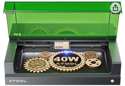

Tool:
xTool S1 40W Laser Engraver

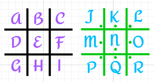

Step 1: Create the Grids
Create the grid by drawing four 4"x1/8" rectangles arranged like a tic-tac-toe game. Use the "Combine" tools in Creative Space to unite the rectangles into one object. Make a copy of this grid and place it adjacent to the original. Add 1/8" circles for the pigs as shown in the pictures. Use the "Combine" tools again to unite the circles and grid into one object.
Step 2: Add the Letters
Add letters A-I in the pens of the first grid. Add letters J-R in the pens of the second grid. I used Amita font with 70 pt size.
