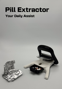

Introduction: Pill Extractor

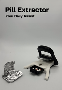

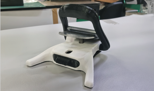

This is a device for dispensing medication from its packaging made for Judith Weisz, as Part of Fixperts course in HIT faculty of design.
This device helps Judith remove the medication from its packaging independently, in an easy way, without needing assistance, and without worrying about fine motor skills

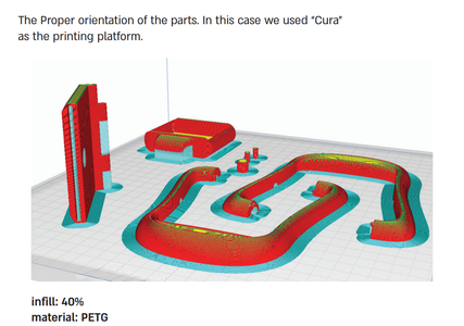

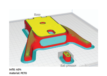

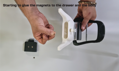

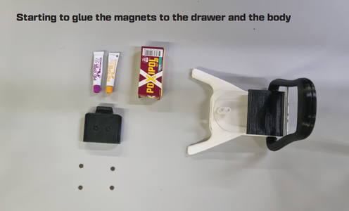

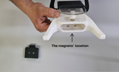

Step 1:
3D printing

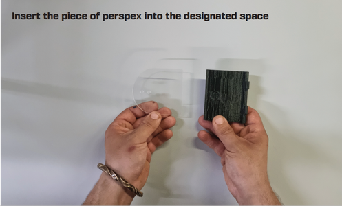

Step 2:
Laser Cutting

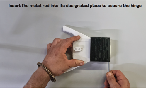

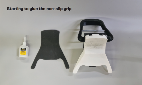

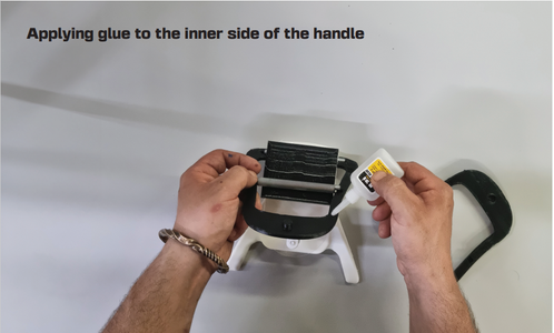

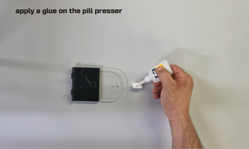

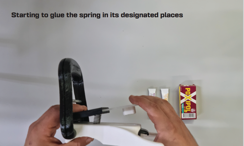

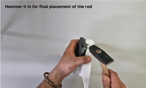

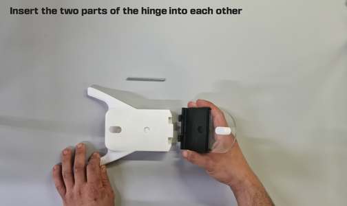

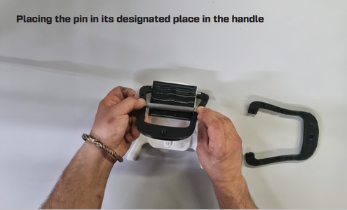

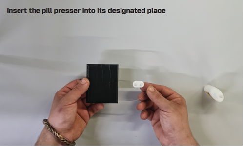

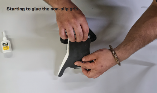

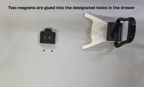

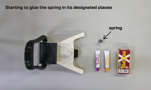

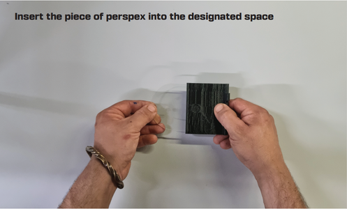

Step 3:

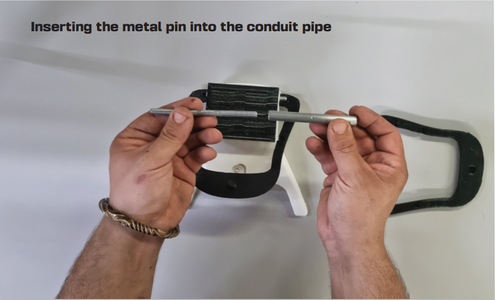

Cutting metal rods

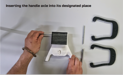

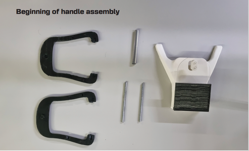

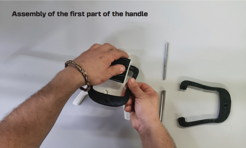

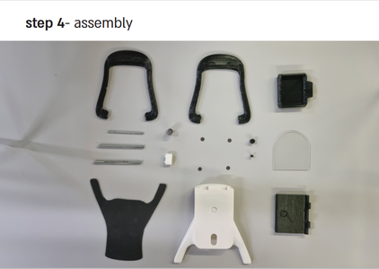

Step 4:

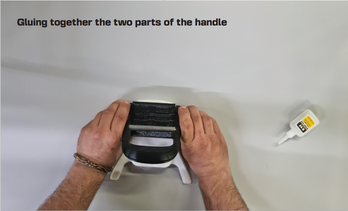

Assembly
