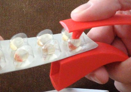

It is really hard for my mother to push pills out of there container because she has artritis.
We got a Ultimaker 2 at my work, so I thought, I’m gonna design a Pill Puncher for my mother. There are already Pill Punchers on the market, but the’re all so small and difficult to handle. Also, the holes are to small for some pills.
So I made a design that fits in your hand, handles easily, and pushes out all different kind of sizes pills out of their container.
Be aware, I’m a beginner in 3D printing, so bear with me.
Step 1: Design the Pill Puncher
I modeled the Pill Puncher in Cinema 4D.
After a lot of sketching, modelling, failed attempts; I came op with this design.
It’s easy to print, and you don’t need a support structure. Just put it on its side and print.
You can download the STL file on Thingiverse.
