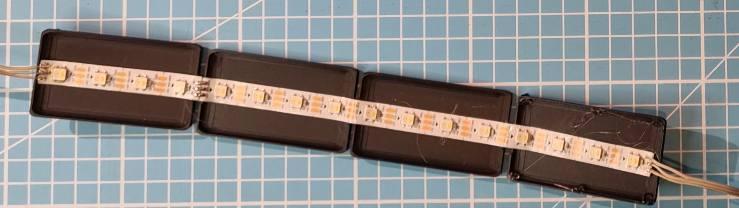

So I started Tinkercad and designed some prototypes. After printing some, I decided to not connect them with cables, but just put them one after the other on the LED strip and connect the rows with cables. Therefore I need boxes with the size of several LEDs on the strip (1.66 cm for 60 LEDs per meter). Since we have short words like to, but also long words like twentyfive, different sizes are needed. The box has an inside size which has to be large enough to hold the leds and an outside size which has to be small enough to leave enough space to the next box between the LEDs. See the following illustration to get an idea how I measured.
|  | LED |           | LED |          | LED | | <== This is the LED strip
|  |  |<--  1.66 cm  -->|  |          |       |
   |<----- 2.4 cm   ----->|< 0.93 cm >|
The overhang of the leds to the left and right is then: 2.4 - 1.66 = 0.74
So we have a inside size of 1.66 * (LEDs-1) + 0.74 and the walls can be up to 0.93 cm / 2 thick. Since we don't need such thick walls, the rest is the distance between the boxes for more flexibility. I decided to have a little bit more space inside and less space between the boxes. The walls are 0,1cm Furthermore I round it to the next decimal. The sizes are:

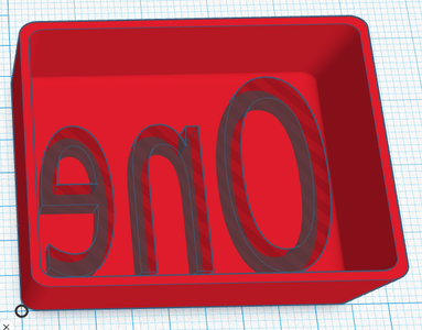

I use Tinkercad to model the Boxes. Since I am in a non-imperial unit country, as you have guessed from the step above, you need to set Tinkercad to Millimeters in the settings on the bottom right.
The design is quite simple, since they are just boxes. To make them a little round I set the radius to 1(mm). By using the ruler tool it is easy to set the exact size of the box. As shown in the step above the measures are:
29mm x 35mm x18mm for the smallest box and increasing the first value for bigger boxes with the values:
29, 45, 62, 78, 95, 111.
Copy the box and make it a hole. Move the hole 1 mm to each dimension and shorten it by 2mm in each dimension. This makes the box hollow. now add a box with the size of your outer box and make it also a hole. move it up by 16mm and group everything together. You now have an open hollow box. For the lid just copy it and move the last hole box down to 2mm.
Add a text and resize it to the box minus 3mm on each side. Set it to hole and 0.3mm above the ground. This makes sure the first layer is solid. To make the text appear correctly on the outside, it has to be mirrored. Choose the mirror tool in the button bar and click on the arrows below the text. When you want to use a different font you can follow this instructable: https://www.instructables.com/Custom-Fonts-in-Tinkercad/

Take your boxes and lay them on the ground according to your layout. You can adapt the layout to your needs according to the size of the pillow. You should have the same amount of lids in the correspondig sizes. Put them in the same pattern.as your boxes. Put the LED strip in the first row and cut it after the last box of the row. Do this for each row. Mark the LED stip parts with numbers or make otherwise sure you don't mix them up.
Solder them toghether to one long stip. Make sure that the direction is correct. There are small triangles on the strip which have to be in the same direction. You can also connect the +5V and GND at the start with the ones at the end to have a better power supply.
