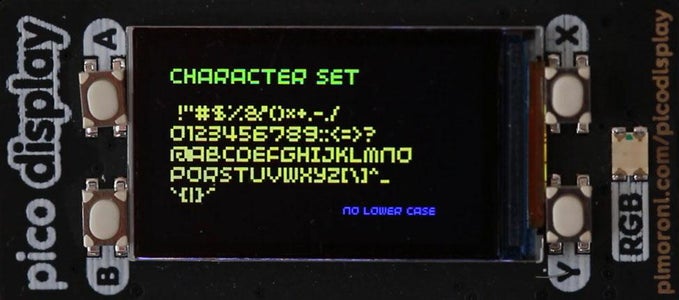

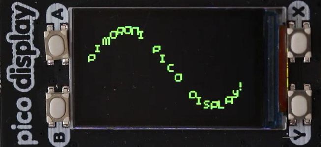

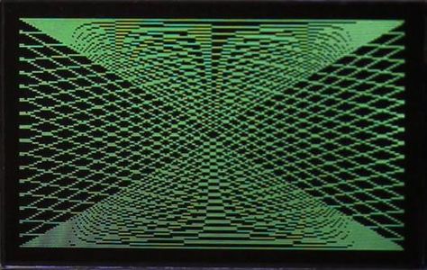

Pimoroni have supplied a few graphics commands - screen clear, filled rectangles and circles, pen colours, pixel, text string and text character printing to the screen. This demonstration adds lines, hollow rectangles and circles, bar and line graphs, user defined characters and how to combine them in various ways to scroll text cross the screen and react to physical changes as buttons are pressed.

The first few sections run automatically. You need to break out of the scrolling text by pressing button Y. Hold it down until the scrolling stops and the program moves on.

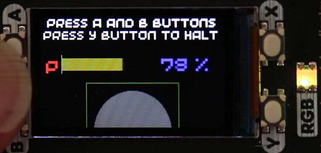

In the bar graph section you can increase values by pressing/tapping button A and decrease with button B. This moves the bar in the graph and changes the colour of the bar and of the built in RGB LED by using PWM. The Y buttons terminates the program with a 'tidy up' section to turn off the LEDs and clear the screen.
