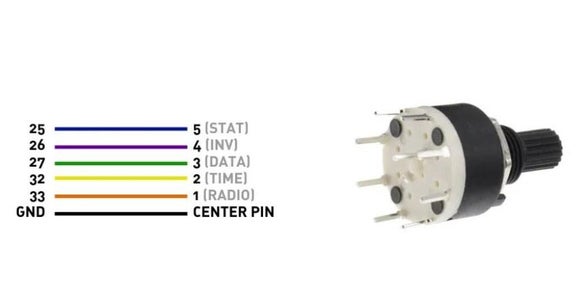

Rotary Selector Switch Wiring
-A simple 2-pole 5-throw switch maps each position to a different ESP32 input, controlling:
  1. Radio
  2. Clock
  3. Temp/Humidity
  4. Inventory
  5. Status screen
You can adjust your pin choices, but common mappings are:
Switch Position to ESP32 Pin
  1. 1 -> GPIO 32
  2. 2 -> GPIO 33
  3. 3 -> GPIO 25
  4. 4 -> GPIO 26
  5. 5 -> GPIO 27
“One dial to rule them all.” -Vault-Tec, probably.
