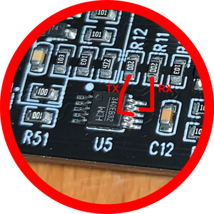

Step 1: Locate the UART Pins…
Arduino RX -> CH340E RXD (Pin 9) -> R11 ->…-> GD32F307VGT6 TX
Arduino TX -> CH340E TXD (Pin 8) -> R12 -> … -> GD32F307VGT6 RX
Step 2: Solder Wires to the Pins…
I used silicone-coated wires because this insulation is heat-resistant.
YELLOW RXD -> R11
GREEN TXD -> R12
RED +5V
BLACK Ground

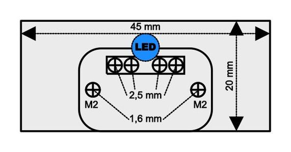

Step 3: Drill Holes...
Drill the holes for the wires with the 2.5 mm drill and the holes for the attachment with the 1.6 mm drill. You then cut an M2 thread into the mounting holes.
Here you find a drilling template:
