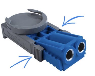

Step 2: Understanding How Kreg’s R3 Works
Before you jump in it’s important to understand how the R3 works. Basically it has two little grey sliders each side. You adjust these to the thickness of your timber, and they then hook over the edge of your timber, and set how close to the edge of the timber the blue body of the Kreg sits.
Here are 3 examples, based on common sized timber we might fix with pocket holes joints…
For ½” thick timber the blue body of the Kreg sits 9mm beyond the edge of the timber
For ¾” timber the blue body of the Kreg sits exactly in line with the edge of the timber.
For 1½” timber (eg CLS studding), the blue body of the Kreg sits 29mm in from the edge of the timber
It’s important to understand this concept, since in our pimped version, we’ll be removing the grey sliders, and positioning our R3 manually in our jig. (Don’t worry, the grey sliders just clip off without any damage and can be refitted in future if using the R3 without a jig).
