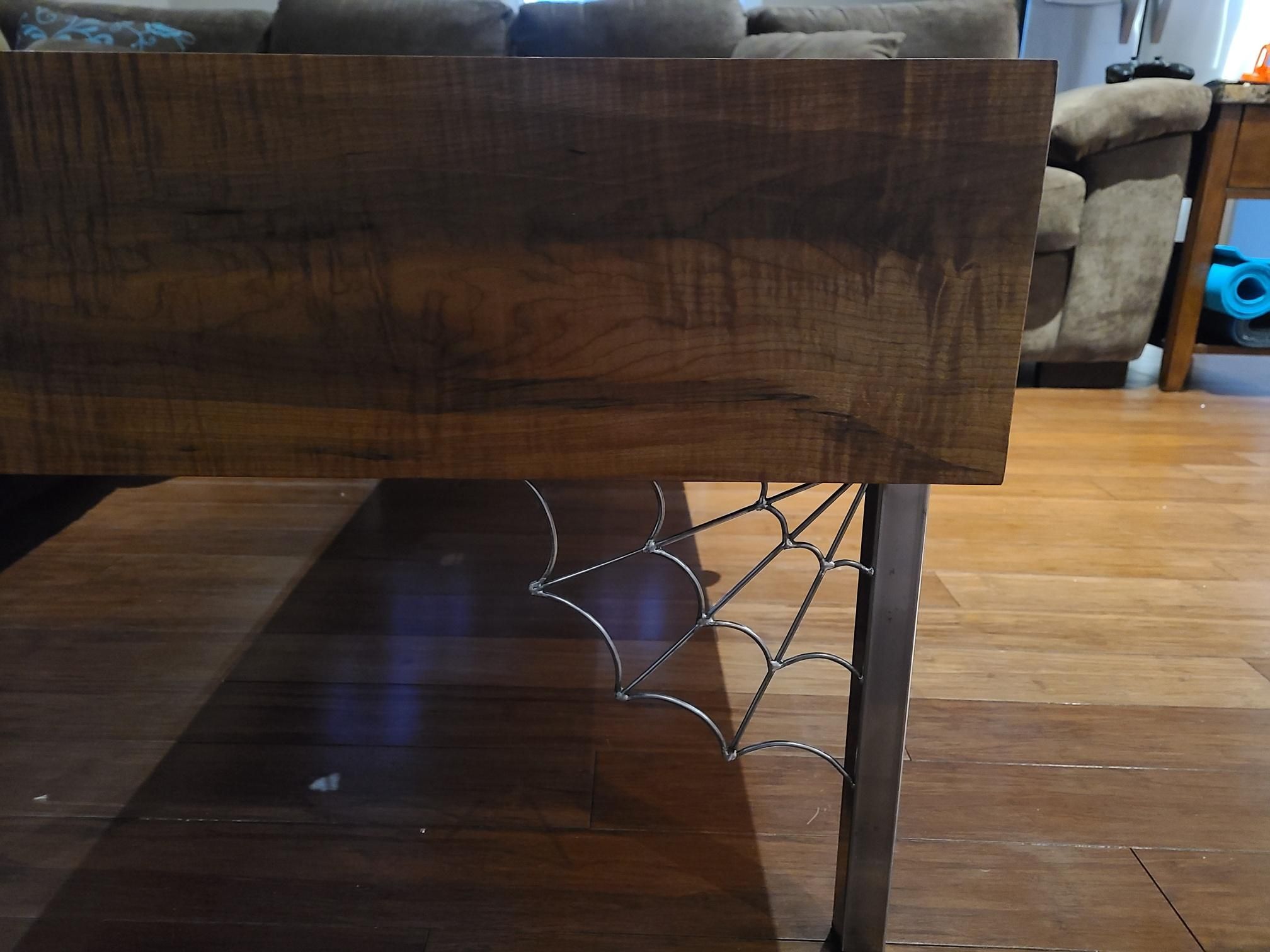

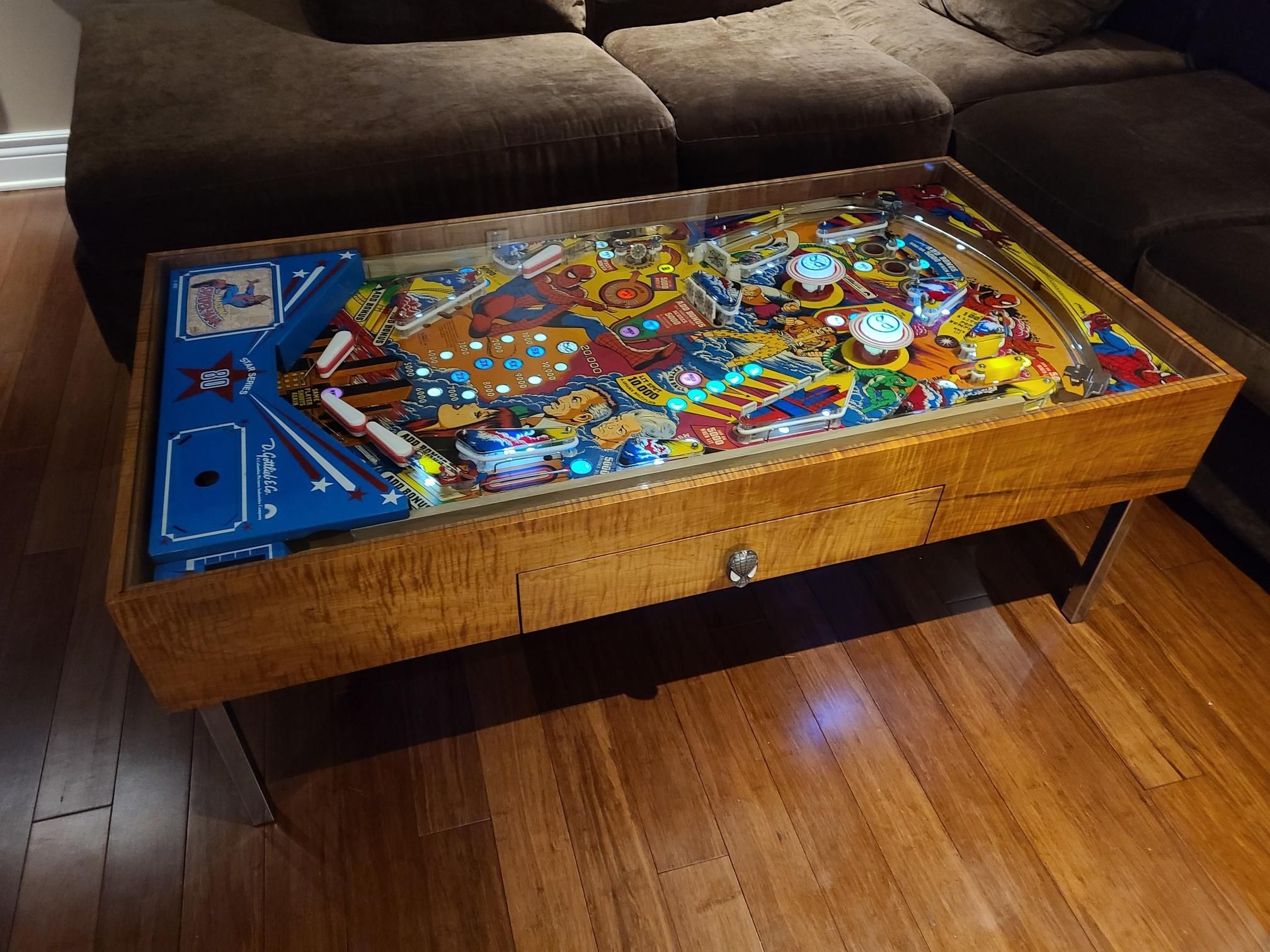

I have had an original Spiderman pinball play surface for a while now and finally got around to building a coffee table from it. It is made of Roasted Maple wood and is lit by LED string lights and a battery. There are online stores that will sell you all new rubbers for the playfield as well to have it looking new again.
20210116_163958_resized_1.jpg20210116_164015_resized_1.jpg20210116_164048_resized_1.jpg
