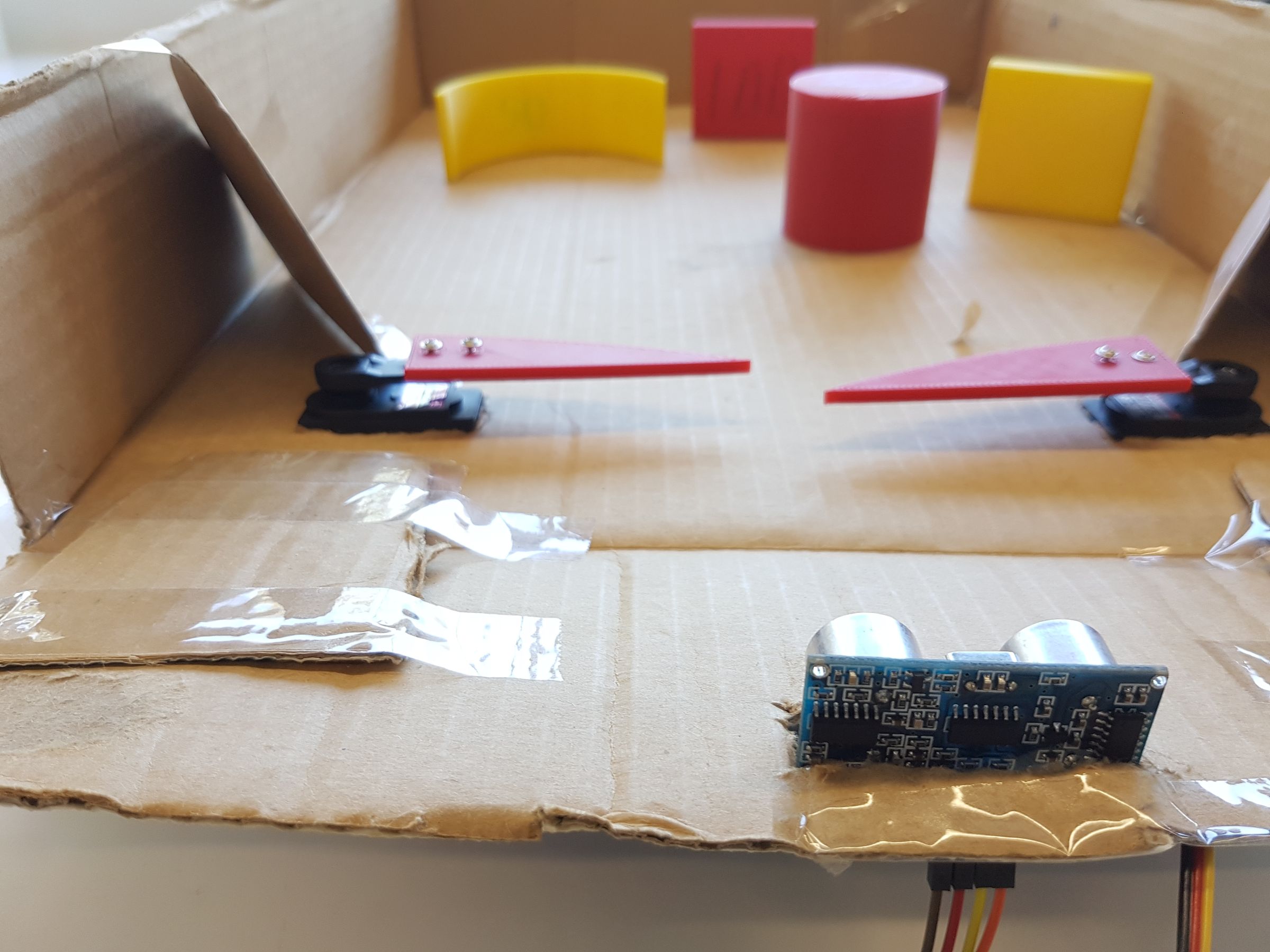

When connecting the circuit layout to the board of the pinball machine, make sure you have at least an A3 sized piece of cardboard (preferably with sides to act as walls).
1.On the piece of cardboard place the 3D printed blocks where you feel they'd work best, trace around the extruded bottom part.
2. Once you've traced an outline of the blocks cut out the area inside the outline (as shown in the picture above).
3. Once there are holes in the cardboard, place the bottom part of the blocks into them (as shown in the picture above), if they don't fit repeat steps 1 and 2 so that you get a bigger hole for the piece to fit in.
4. At the end of the cardboard leave a flattened bit with no walls, in this area cut out a small rectangle for the ultrasonic sensor to fit in.
5. Next, use screws (1.5mm width, around 8mm height) to connect the 3D printed flippers to the servos.
6. Next, trace the bottom of the servos out onto the cardboard - leaving at least a 5cm gap between these and the ultrasonic sensor, cut out the inside of this outline then place the two servos in their respective holes (with flipper attached).
7. Check that the servos are able to support the cardboard, with a gap of only 1.5cm maximum between the middle of flippers and the top of the cardboard. If this isn't the case use super glue on the servos to line the flippers up with the cardboard. (Reference above picture for steps 4 - 7)
8. To help move the ball back to the flippers, you can lean cardboard from the wall to the edge of the servo (seen in the picture above).
