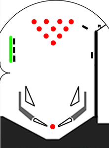

Step 1: Planning the Play-area
For the play area it is important to know where you want certaint things to go. Because what kind of target you want defines the sensor you will use.
In the above plans you can see i have a triangle shaped array of targets. These targets are flush with the play field. the three targets on the left are switches you hit with the ball. the right side can either have two more targets to hit or a horseshoe ball guide. in this ballguide we wil be putting two optical sensors.
You can ofcourse choose other places for the targets or other target types. note that the red bottom circle will not be used for my machine.

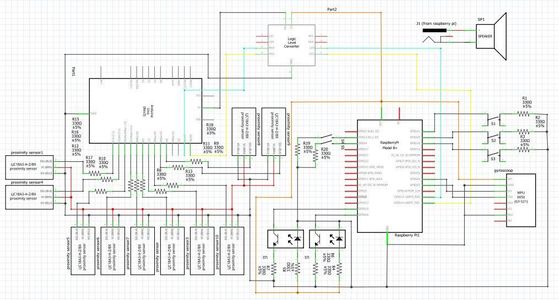

A-14231-2 (williams opto set):
We can see the first board has some kind of led but no resistor, so we can just make a connection with a resitor in series. The second board uses some kind of npn transistor and only the emiter and collector are able to be connected. We can connect this like a button to our raspberry pi.
Sometimes we get easier images like for the lj8a3-2-z/ax (inductive proximity sensor):
SIG = singal pin (high or low) indicated by a black wire
VI = voltage in (5V) indicated by a brown wire
VO = voltage out/ground indicated by a blue wire
The mpu6050 is a bit harder to use but there are alot of librarys you can use (or make your own):
but this is the method of getting data out of the component
With the I2c adress we can ask the mpu6050 to give us the data from two certain memory slots.
we then have to use some code to stick these bytes together. But the order is important (double check on the datasheet)
After sticking these togheter you can just read it as a float for the directional speed.

Step 4: Wiring the Sensors
the next step is to wire all the sensors to the playfield + the raspberry pi
i used screws and zipties to hold the wires together so i cankeep them organized. and also to secure the breadboards or other components. if you can u should ofcourse use the screw holes made for securing these up walls.
