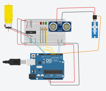

Step 1: Design Tinker Cad
The first step is to create the circuit on Tinkercad to better understand how it works before proceeding with the physical construction. The diagram provided above shows the complete circuit for the electronic components. The only modification needed is the motor controller. The one available in Tinkercad is different from the one included in the SparkFun kits. While both motor controllers function the same way, the SparkFun version has a slightly different wiring order.
Step 2: The Code
The code needed for this to work is available for download below. It is quite simple, consisting of a single if statement that controls when the servo moves and the wheel spins. This if statement is triggered based on the distance detected by the sensor.

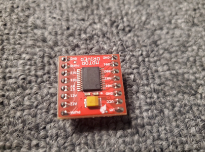

Step 3: Adjusting the Circuit From Tinkercad to Physical
To properly be able to use the project the motor controller needs to be changed from the one in Tinker Cad.
Motor hookup
Vm – needs to be hooked up to a separate battery
Vcc – power for driver -5V
GND – ground -GND
A01red(+) output to motors red motor wire
A02black(-) output to motors black motor wire
PWMA – speed motor 1 - D11 (needs PWM)
AIN2 – direction motor 1 - D12
AIN1 – direction motor 1 - D13
STBY– for internal Hbridge - 5V
These are the proper hook ups for the sprakfun motor controller that corilate to the propper spots on the board.
