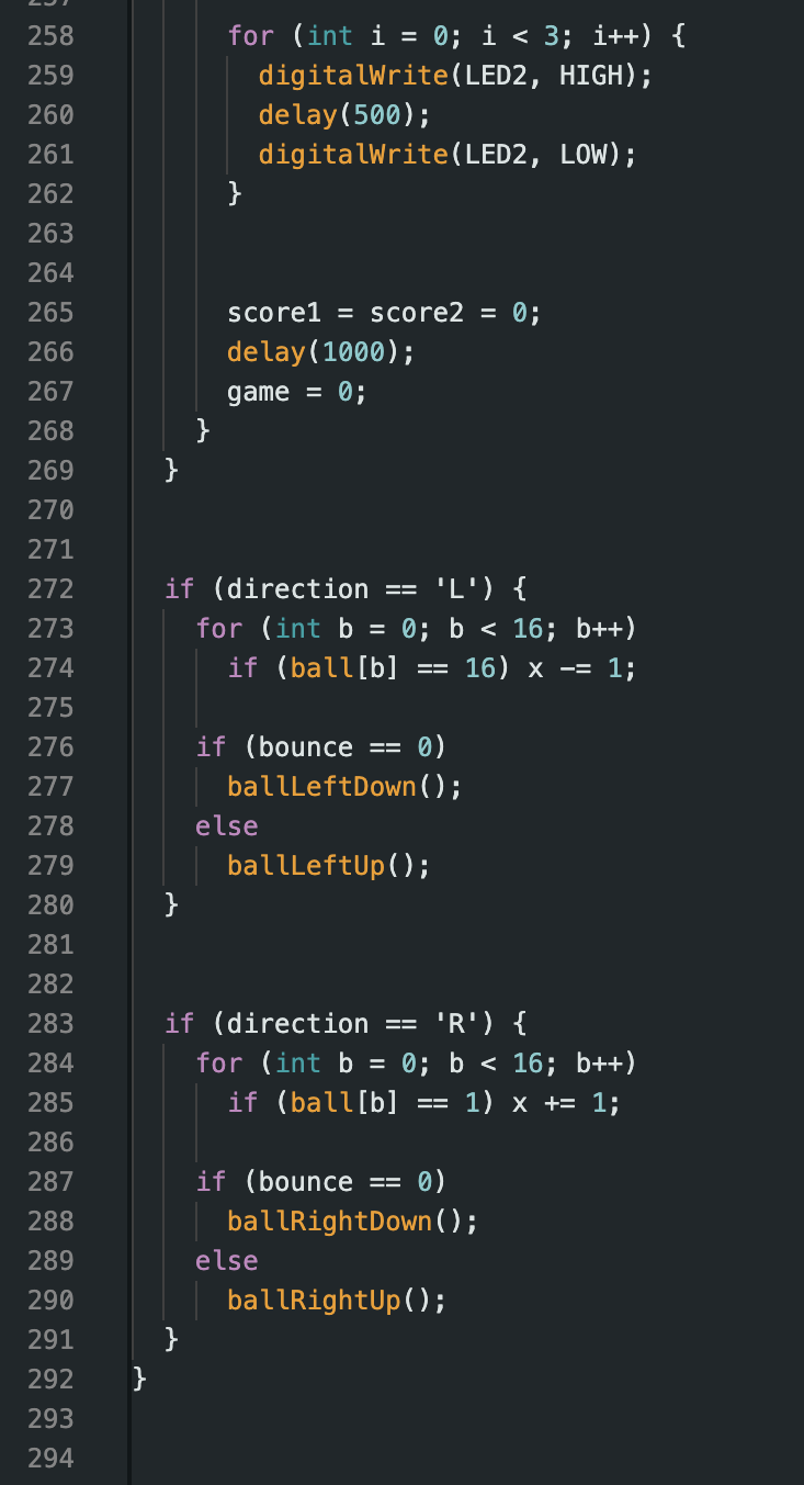

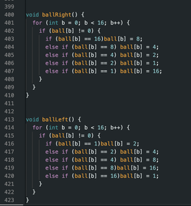

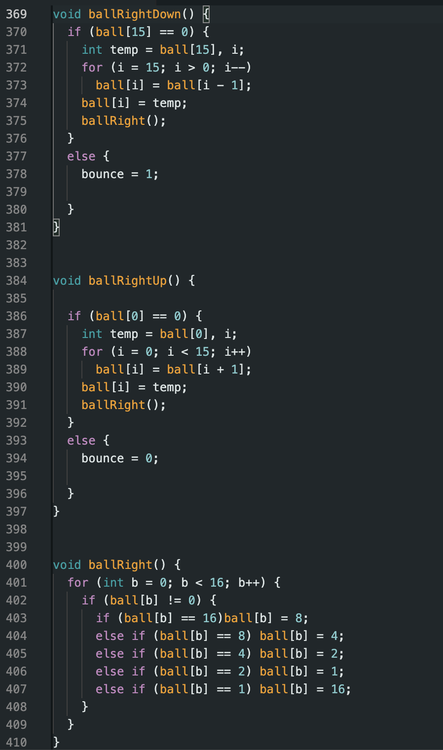

Before we get started on the void setup, we are going to insert the LiquidCrystal library and also identify the pins that get connected to the Arduino from the LCD. We then define what other pins are connected to the Arduino while making the variable names. As for the arrays, we are making arrays for the paddles and the ball. This is to make the paddle and ball and to also hold the values. For the next part we are going to set everything to 0 and also identify the direction as left so that the ball will always start going to the left.

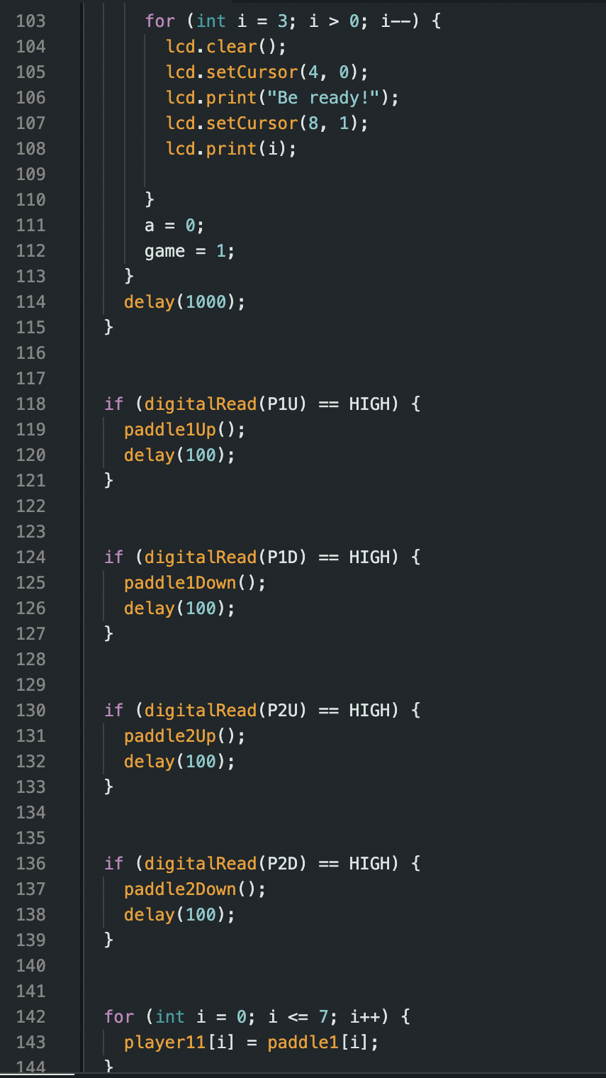

For the void setup, we are going to start by defining which one is input and which one is output. After that we are going to print text on the LCD.
lcd.begin - begins lcd communication
lcd.clear - clears the lcd screen
lcd.setCursor - sets cursor
lcd.print - prints text

In the void loop we are going to be making a lot of if statements and checking if the button has been pressed. This is where the main part of the game is made because of all the functions.
Step 6: Code
This part is for the functions that are added in the void loop.
