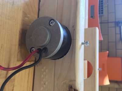

Step 2: Prepare Holes for the Motor
The first step of the process was to make holes tight enough for the motors to not wiggle around in. To do this, we used a power drill with a circular drill bit on it to make the holes. Before you do this, find the diameter of the motor first and then cut the hole. A lot of sanding may be required to get the hole big enough. Try not to get the hole too big, however, because the motor will fall out.
Step 3: Bolting the Motors In
After the holes have been drilled, it is time to make sure they are secured. If you get your hole tight enough, this step may not be necessary. In our case, we used an Allen Wrench and bolts to keep the motors secure.
