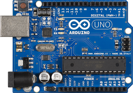

An Arduino, whichever variety takes your fancy, however we used the standard Arduino UNO R3;

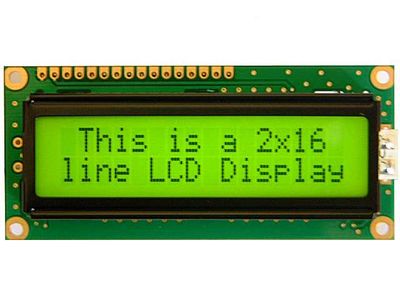

And if you want to use an LCD display, then an LCD display! we'll explain how to wire that up too.

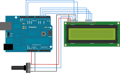

Step 3: Connecting the Components Together, for Now...
First off the essentials:
1.Connect the power bus to the Arduinos 5V power supply
2. Connect the 2 buttons to power and then to a 220Ohm resistor to ground in order to prevent any false presses being read by the digital inputs.
3. Wire the 1st potentiometer to 5V and ground, and then connect the wiper (the 3rd pin) to an analog input.
4. Lastly, to connect the LCD dislplay: you will want to use the fritzing diagram above as a reference. Make sure you connect the 2nd potentiometers wiper to the VO pin and wire the backlight +/- to the power bus as otherwise you'll wonder why nothings happening!
5. Makes a note of which pins you have connected to what (such as "Potentiometer to A2" or which digital pins you have connected the LCD to), as this will make it easier for you later to modify your code instead of rewiring everything!
6. Plug in your arduino, and open up your IDE...

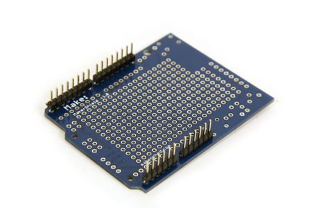

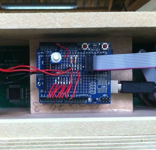

which will show you how to wire up to the Arduino for testing, this is only a temporary option however as the cables will easily fall out if not secured properly - we will need to translate all of the wiring from the breadboard onto a proto-board, preferably one that mounts straight onto the Arduino, and GND and 5V rails built in as this will save you some wiring.
Make sure you find a spot on the proto-board that will allow for the two ribbon cables to be connected at the same time and close together, as these might get in each others way or interfere with other components, its a good idea to try and imagine what the final circuit will look like before committing to soldering as this isn't that easily corrected.
The cables connect to the underside of the proto-board and will wire underneath and back up into the digital in pin. if you DO make a mistake at this point in the process though fear not, you can always change the pin numbering in the Arduino sketch afterwards. My wiring is a bit messy, but try and make this as neat as possible as space between the proto-board and the Arduino is extremely limited!
The buttons are connected to 5V on one side, and on the other connected to ground AND its respective pin.

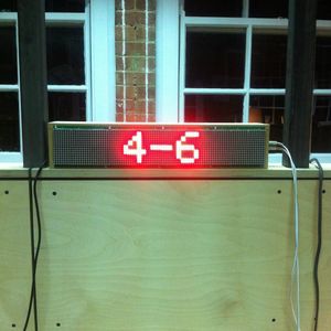

Step 6: Building a Box
The panels will need to be secured in some way. For quite some time these were cable tied to a piece of cardboard, which whilst at first was very 'indie' and kinda cool ultimately was structurally unsound and after a while a bit of an eyesore. Included in the github folder is a concept for a box as an illustrator (.ai) file, if you have a laser cutter handy (we didn't), feel free to use this one, and make sure you use 12mm MDF if you do otherwise the joints will not interlock properly.

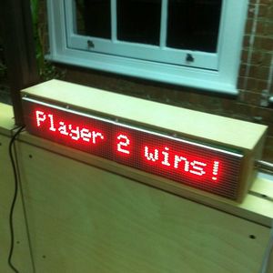

In the end, simplicity prevailed and ours looks like the one in the photographs. The dimensions of the wood cuts are (all made from 12mm thick MDF): 2 pieces 74mm long x 100mm wide for the sides, 2 pieces 480mm long x 100mm wide, one off-cut 74mm x 10mm was used to mount the Arduino onto.
We used a couple of project boxes from a DIY shop to house the buttons in, and these are wired to MONO 3.5mm phono plugs on the box, then onto the proto-board!
Step 7: The End!
There you have it. If all went well you should now have a fully functioning scoreboard!
