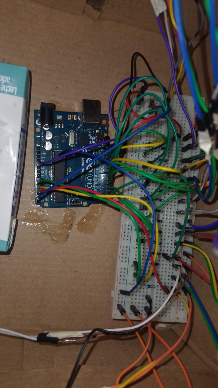

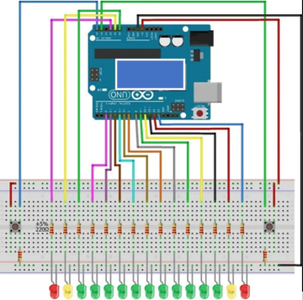

Step 1: Arduino to Breadboard Design
Step 1: Assembling the Circuit on the Breadboard
Prepare the Components
Gather all the necessary materials: Arduino Uno, breadboard, 15 LEDs, 15 resistors (220 ohm or 330 ohm), jumpers, and two buttons.
Placing the LEDs and Resistors on the Breadboard
Insert the 15 LEDs into the breadboard in a horizontal row.
Place a resistor in series with each LED. One end of the resistor should be connected to the anode (long leg) of the LED and the other end should be in a separate row on the breadboard.
Connecting the LEDs to the Arduino
Use jumper wires to connect the LEDs to the Arduino's digital inputs according to the following layout:
The first three LEDs connect to the Arduino's analog inputs A0, A1, and A2.
The next six LEDs connect to the Arduino's digital inputs 2, 3, 4, 5, 6, and 7.
The last six LEDs connect to digital inputs 8, 9, 10, 11, 12, and 13 on the Arduino.
Connecting Power to the Breadboard
Connect the Arduino's GND input to the ground (negative) line on the breadboard using a jumper wire.
Connect the Arduino's 5V input to the power (positive) line on the breadboard using another jumper wire.
Adding the Buttons
Insert two buttons into the breadboard. Make sure each button has one leg connected to a different row on the breadboard.
Connect a resistor to each button, making sure one end of the resistor is connected to one leg of the button and the other end to the ground (negative) line on the breadboard.
Connect the buttons to analog inputs A4 (left button) and A5 (right button) on the Arduino using jumper wires.

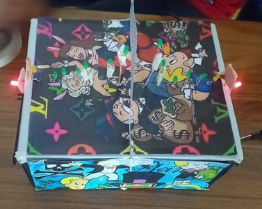

Step 3: Extending the LEDs and Buttons
To extend the 15 LEDs and the two buttons, dual jumper wires will be used. This will allow the LEDs and buttons to be placed neatly and accessible for the game to play on.
Instructions for Extending the LEDs and Buttons
Extending the LEDs
Each LED is already connected to the breadboard with a jumper wire.
Take an additional jumper wire and connect it in parallel with each LED, i.e. one end of the jumper connects to the LED pin and the other end to the corresponding pin on the breadboard.
Do this for each of the 15 LEDs.
Make sure to maintain the correct order and polarity when connecting the dual jumpers.
Extending the Buttons
Each button is already connected to the breadboard with a jumper wire.
Take an additional jumper wire and connect it in parallel with each button, similar to how you did with the LEDs.
Connect one end of the jumper to one pin of the button and the other end to the corresponding pin on the breadboard.
Do this for both buttons.
Step 4: Preparing and Decorating the Box
In this step, you will prepare the box to house the LEDs and buttons, as well as decorate it to your desired theme. Detailed steps for performing this task are outlined below.
Instructions for Preparing and Decorating the Box
Measuring and Marking LED Positions
Use a ruler to measure and mark 15 equidistant points on the top of the box, forming a horizontal line.
Make sure the marks are centered and aligned correctly.
Drilling Holes for the LEDs
Use a suitable tool (such as a drill or hand-held hole punch) to make 15 holes at the marked points.
Make sure the holes are the appropriate size for the LEDs to fit securely.
Placing the LEDs in the Holes
Insert each LED through the holes from the inside of the box to the outside.
Make sure the LEDs are tight and aligned.
Installing Buttons on the Outside of the Case
Choose two accessible locations on the sides of the case for the buttons, so that they are easy to press during gameplay.
Drill suitable holes for the buttons in the selected positions.
Insert and secure the buttons into these holes, making sure they are firmly attached.
Connecting the LEDs and Buttons to the Breadboard
Connect the jumper wires from the LEDs and buttons to the breadboard following the connections previously established.
Make sure all connections are secure and correct.
Decorating the Case
Decorate the case according to your desired theme, whether it is ping pong related or some other game.
Use paints, adhesives, stickers, or other decorative materials to personalize the case.
Make sure not to obstruct the LEDs or buttons with decoration.
Step 5: Final Check
Final Check
Check All Connections
Check all electrical connections to ensure that the LEDs and buttons are properly connected and function as expected.
Test Game Operation
Connect the Arduino to the laptop and upload the code.
Test the game to ensure that the LEDs light up in the correct sequence and that the buttons respond appropriately.
Make Necessary Adjustments
If any LEDs or buttons do not function properly, check the connections and adjust as necessary.
Make sure the case is well decorated and that the buttons are accessible and comfortable to use.
